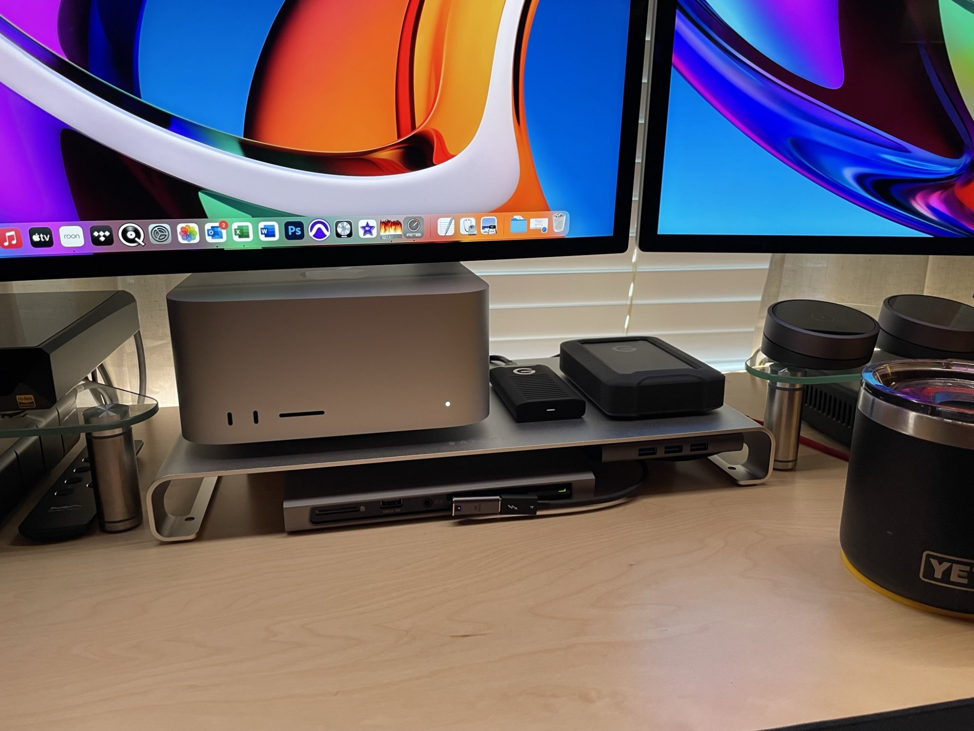

Get a monitor riser for your Mac Studio and be done!!
