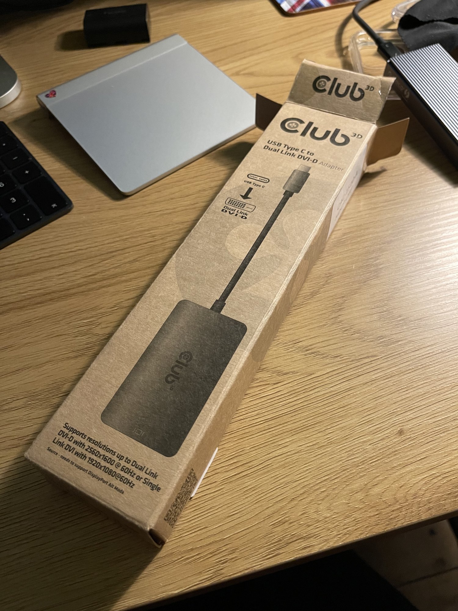

Well, Club 3D (CAC-1510-A) worked as expected. The monitors work flawlessly and also wake up from sleep.
From ally my tests it seems that this is the only 100% compatible solution. I will see how it looks in the long run.

I have used the Club3D adapter to connect a 30” Cinema HD display and a Mac Studio (and other modern Macs) and it is the only thing between the display and the Mac. It replaces the Apple dual link adapter.

That's the one I have used with two different Mac Minis and a Mac Studio. All worked just fine.

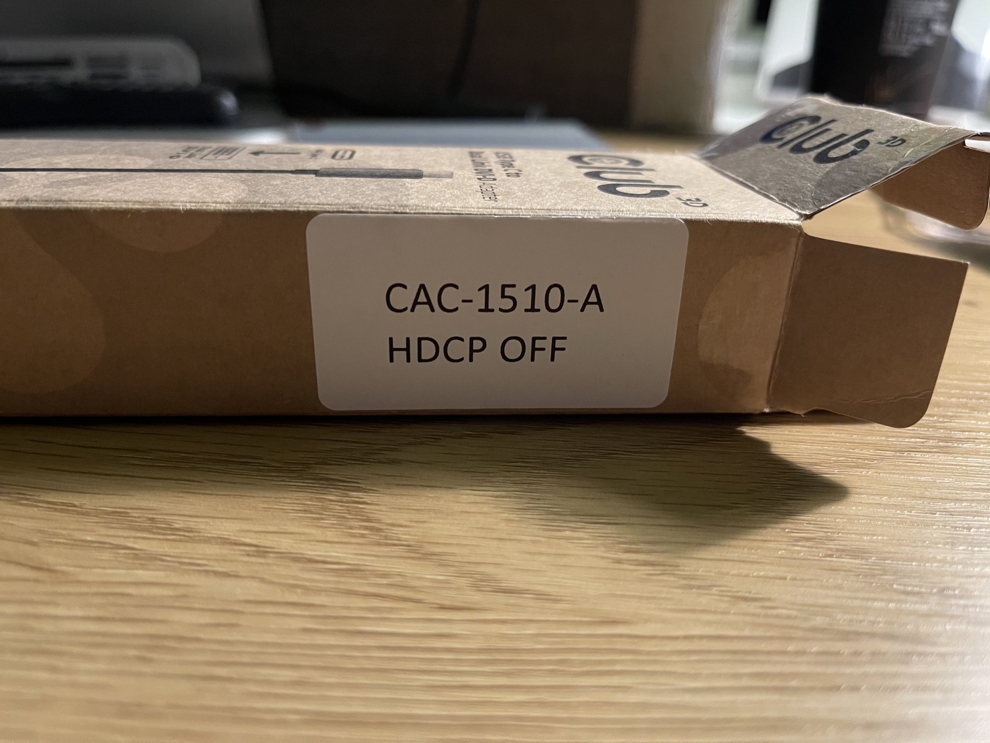

The only adapter I have tried that worked consistently with M1 Mini and ACD 30" (2008) the Club CAC1510A with HDCP off. I got mine on Amazon. After you set resolution to the native 2560 x 1600 the first time it keeps it there. Other adapters I tried would drop the signal if the display was off and needed to be reconnected everytime the system wakes up, a real PITA. (I am assuming this will work from a Studio but have not tried it).
