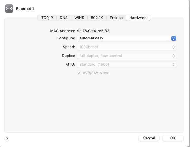

Have you tried letting the hardware set itself up automatically rather than manually?

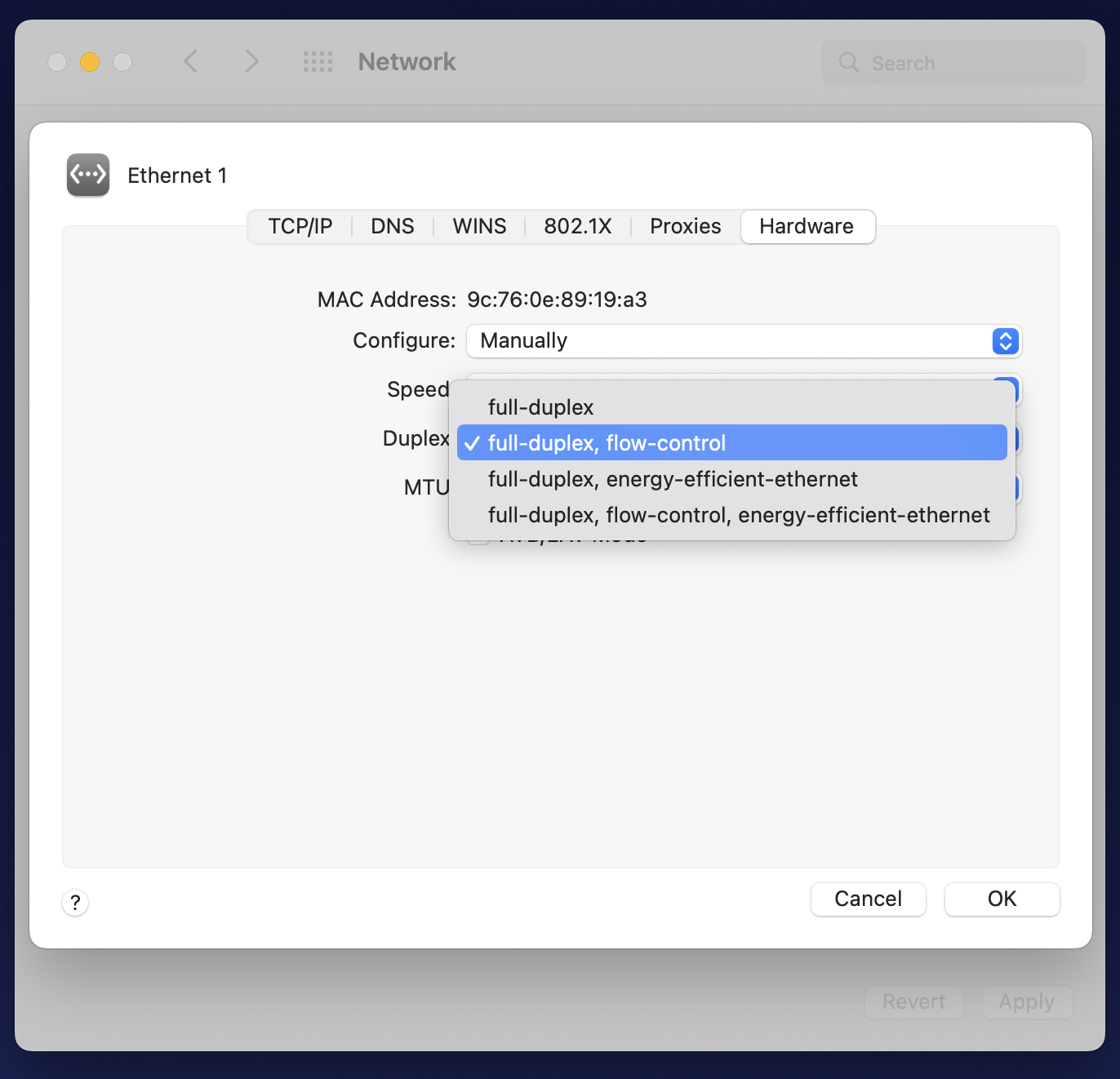

I don’t think you are alone on this. I keep getting drops when using the Ethernet port on device. Using the Ethernet on my OWC Thunderbolt dock has no issues. Hopefully it’s a software problem because I really wanted built in 10 Gbe
If your Ethernet connection is dropping, try configuring it manually and make sure that one of the “energy-efficient Ethernet” choices is NOT enabled.
