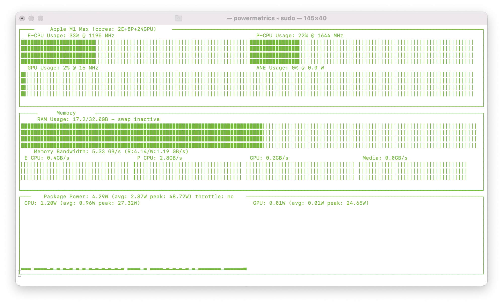

With my workload I haven't been able to push the package power over 49W, despite hitting both CPU and GPU pretty hard on the M1 Max Mac Studio. That's a peak of around 28W for the CPU and 25W for the GPU.
That is interesting. On the 24 GPU core M1 Max 16" MBP, you can definitely hit 37 watts on the GPU running GFX Bench.
