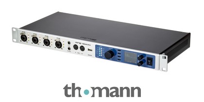

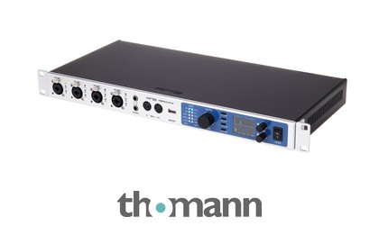

I suggest external soundcard and balanced cables.
then we are already talking about more expensive cards...
example:
Next are Avid, Antelope and Universal Audio bigger boxes. with them, monitor controllers are already necessary.
