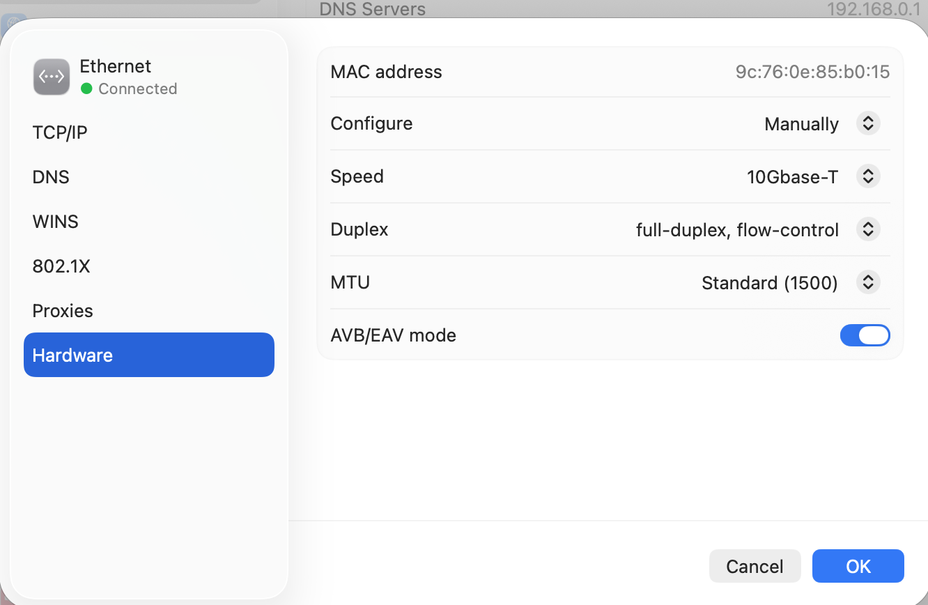

Check the hardware settings part of the Ethernet pane in Settings. You can force it to your desired speed. I have had trouble with Auto mode in that setting.

For reference my, home is wired with 8 drops of Cat6 with a Cisco RV340, all drops to the router run at 1000baseT with Netgear Gb switches. New to the M2 Max Studio. Noticed that the ethernet automatic speed was 100baseTx on a 1000baseT network. It was a basic drop in, pull the M2 pro mini, drop in the studio. I checked the cabling everything looked fine. Basic trouble shooting showed the Cat5E cable to the wall was the problem. Replaced with Cat6 running at 1000BaseT. BTW those who showed manual settings, In my case did not work, no matter setting in Macos the Studio and router showed 100baseT while the Mac showed 1000baseT, A bug of its own.
