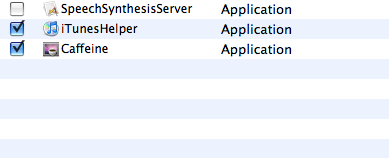

The login items say:

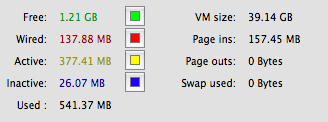

in Activity Monitor under the System Memory tab type out or post a screenshot of the stats.

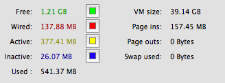

I'm not sure if this makes a difference, but here is my disk activity chart. The place where there is the very high peek is seconds after login. Does this make a difference. Does that mean the system is trying to access something?
That's normal.
How long is it taking to start up? I'd say for an clean system, a minute isn't all that out of the ordinary. If you really want to see fast boot up times, buy a bigger/faster harddrive, or consider a SSD.
