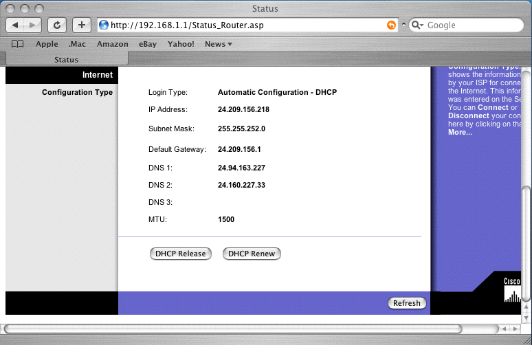

Thanks guys for the responses. Yes, I also have a Linksys Router and yes I can into the interface and assign different local static ip's to my different mac's. example: PB: 192.168.1.100 Mini: 192.168.1.101 G4: 192.168.1.102. Unless I set the network configuration in the wireless card to DHCP I do not connect. I realize I need to add the DNS address to the if I am going to configure it manually. The ISP tech support would not disclose this info (comcast) So all I need to do is get that DNS address while I am connected while in DHCP. Hope you guys got all that lol.

Log into your routers admin panel and look at the Status. It gives you the DNS servers it picked up from your modem.
I also use some supposedly public DNS servers at 4.2.2.2 and 4.2.2.3 which are tons faster than RR's.
