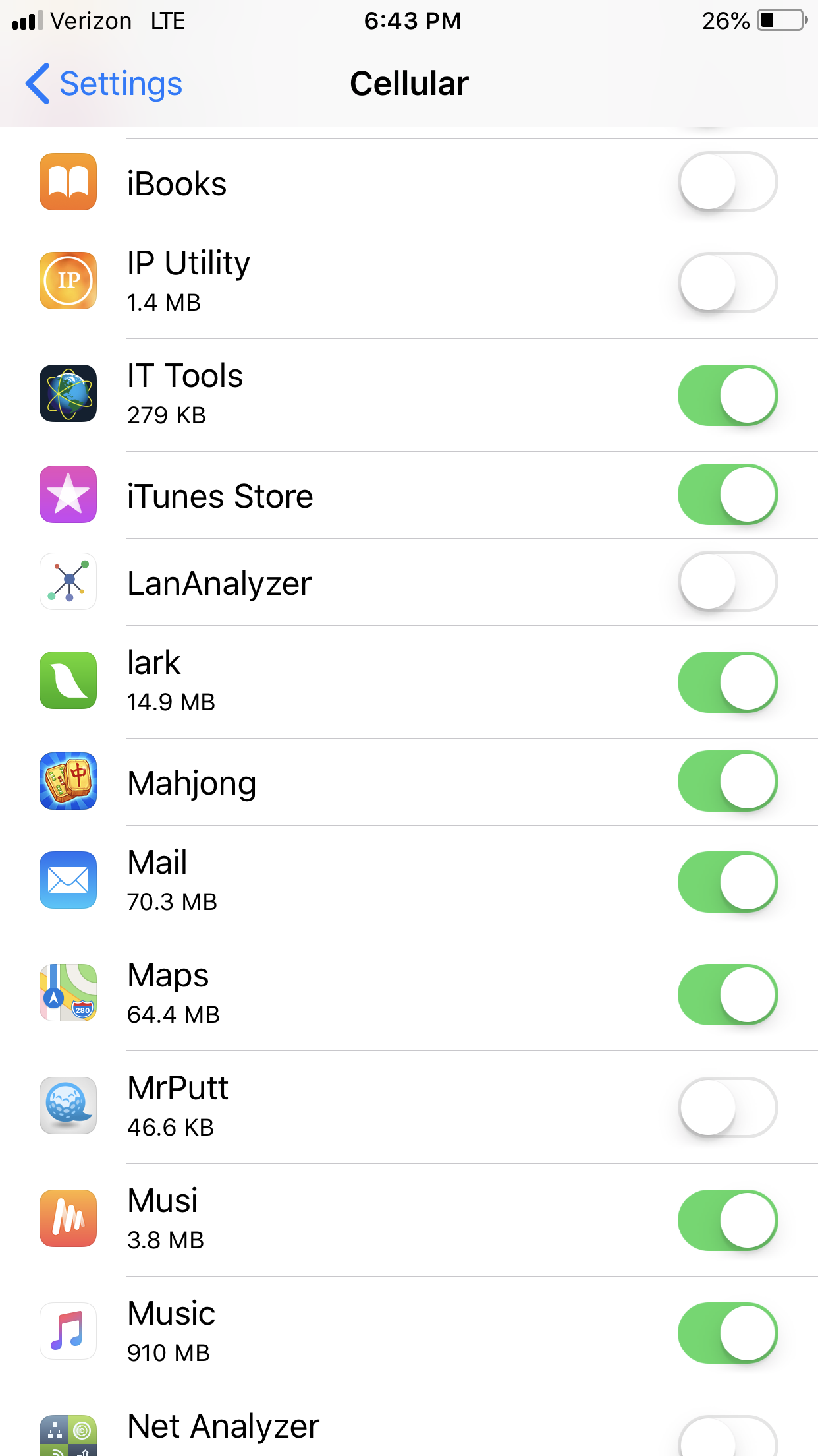

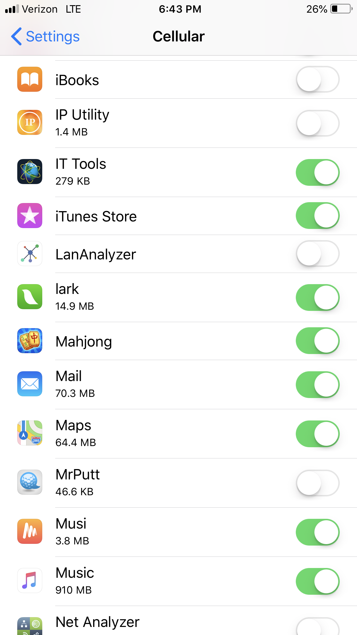

Well to give some background I had moved with my bf at the time now fiancé from the city to a very rural area where there is no WiFi and we have to rely on our cell phones and hot spot. I’ve worked in the Silicon Valley for startups for over ten years and I’m an accountant but a computer nerd at heart and I actually handle the operations side of accounting, long story short Im not shy around computers and am the family IT person and for the past two years have had to learn networking because of all going on. We hired an IT person a year ago too. So like I was saying since we moved here it started with my iPhone 6 Plus at the time began acting strange. Freezing, icons at the top shifting. My passwords would stop working and it became a daily thing of resetting all passwords, I got a new phone 6s plus. It only got worse. My keyboard would delete words as I typed them. It was happening to all of us but mainly me. It started getting really strange. All our devices and email began to be inundated with porn and some was worth me calling a friend in law enforcement. My phones old and new on day just became disabled. Poof! My Mac would tell me someone was logged in, we talked to Apple, I’ve reset all devices more than once, replaced SIM cards, my Mac then was disabled (my boyfriend had an android and a surface if this matters. My car stereo was an android) I have been VERY conservative no 3rd party software, my devices were work related and so I kept them clean and updated. The IT guy said he’s never seen devices in such good condition. He reset everything but we got new phones 7plus and I switched carriers. Att to Verizon! It calmed down for a bit then it started again and Python has been installed(?) my iCloud account at times was inaccessible. I’ve learned command line and it’s th only thing that keeps me sane and Apple has confirmed there is some developer stuff being accessed but also a lot of native apple stuff. My MacBook Pro retina is a developer system my work gave me as a gift and so Xcode & Automater, text wrangler are all installed and I suspect they play a huge part in the problem. I can tell you that with WiFi off, sharing off, Finder has been rearranged magically, I’ve turned my firewall on highest settings, and I’ve attached a screenshot of my Mac presently. This is actually pretty quiet. Sometime each interface will show an established connection with everything off. And there are constantly signs of Microsoft programs or processes running my word and excel have become unusable. The newest since yesterday on my phone the app called ‘Mr Putt’ appears under Cellular but no where else. I do not own any app by this name
[doublepost=1530583494][/doublepost]I can’t upload the pictures showing my Mac right now but under Sudo in the terminal using NEttop or lsof -I interfaces lo0 process ‘node’ and Wifiagent have an established connection, awdl0 mDNS respnder is on. Web pages will be obviously spoofed. There is a ddglot of signs of DDos attack. My keyboard is being hijacked again. So let me know what I can provide to help pinpoint the culprit or is there a command I can use that will help me?
Also port 1720 is always open I can’t figure out what’s causing it.
Beam.smp.80 has 24 processes open under lo0 via tcp localhost
Launchd has 6 processes using both ups/tcp two of which are river rock and 4 are using a hidden ipv4 address *:625<->*:* the other s same but numbs inside of 138, Xcscontrol tcp4 via localhost.
S
Thank you!!
