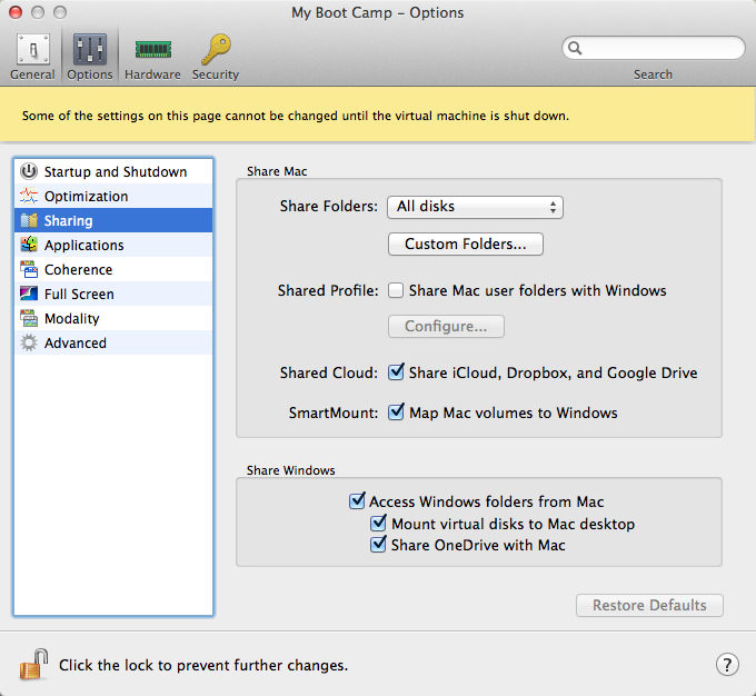

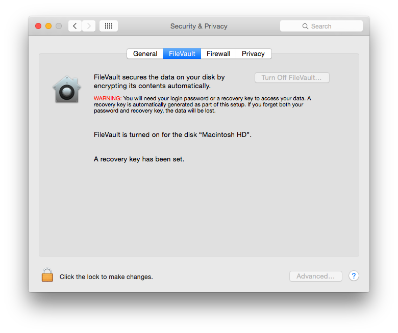

Do you have firevault turned on?
Firewall off.

Firevault not firewall 😉

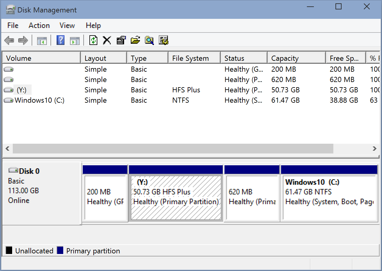

If your OSX partition says RAW it means you have no driver installed. If it says HFS Plus then you do. Depending on what it looks like you may need to install a driver (either Apple's Bootcamp or Paragon's HFS+) or simply right click and assign a drive letter.
Please upload the output of the terminal command above and disk management window so we can see.

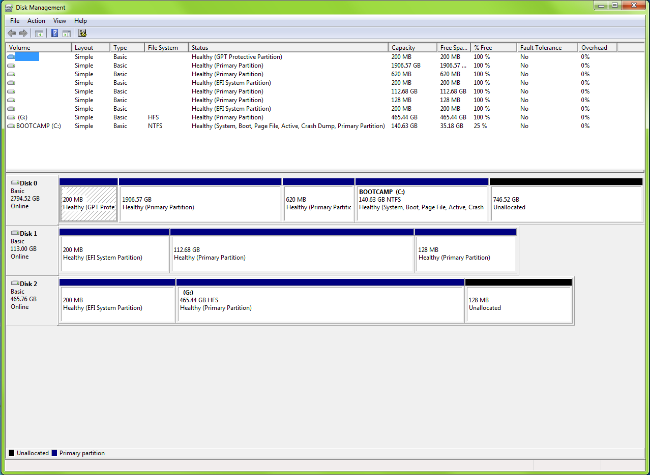

The Disk Management print screen is attached.
"G" is an external Mac-formatted drive.
CoreStorage probably disabled.
Alas not - corestorage is enabled otherwise it would say No CoreStorage logical volume groups found. You have a fusion drive made up of these partitions: disk0s1 (121GB your SSD), disk1s2 (2TB) and disk1s5 (801GB). These combine to make a logical volume called "Macintosh HD" which is 3TB.
You can see your G:\ drive on your Samsung disk because it is HFS. You can't see the volumes that make up "Macintosh HD" because they are not HFS - they are corestorage.
I've formatted your diskutil list from above, CoreStorage in red, HFS and FAT (what windows can identify) in green..
If you compare the numbers (which are slightly smaller on Windows due to it thinking there are 1024 bytes in a KB and Apple thinking there are 1000) you can see the CoreStorage volumes identified as partitions of an unknown type. This is because you haven't got a driver because none exist - either Apple or third party.
However, if you are used to seeing your HFS+ partition from Windows, you will not be happy. Currently, there are no CoreStorage drivers for Windows (or any other operating system). This means you will not be able to read your OS X partition from Windows, nor will third-party HFS+ read-write drivers work with the CoreStorage volume.
http://www.appleexaminer.com/files/category-corestorage.html
Comparing your disk layout between OSX and Windows
Disk 0 on bootcamp is /dev/disk1, only the NTFS BOOTCAMP partition can be identified. The first corestorage disk1s2 can be seen but not identified as it is not HFS or any other format Windows knows about. disk1s5 shows as unallocated as the hybrid mbr can only cope with 4 partitions.
Disk 1 on bootcamp is /dev/disk0 (the SSD). EFI partition is a recognized type but Windows doesn't automatically mount EFI partitions, the other partition types (CoreStorage and Apple Boot) aren't recognized.
Disk 2 on Windows is the Samsung that works as Windows has an HFS driver installed. Again the EFI is recognized but not mounted.
(You have removed the 4GB flash drive)
AFAIK your only options are to wait (perhaps indefinitely) for a driver or scrap the fusion drive set-up and re-install everything not using logical volumes. As I said before though I don't have a fusion drive so I've not researched this.
How it worked before I'm afraid I've no idea as what I've been able to find is you can't access HFS CoreStorage volumes from bootcamp 🙁
