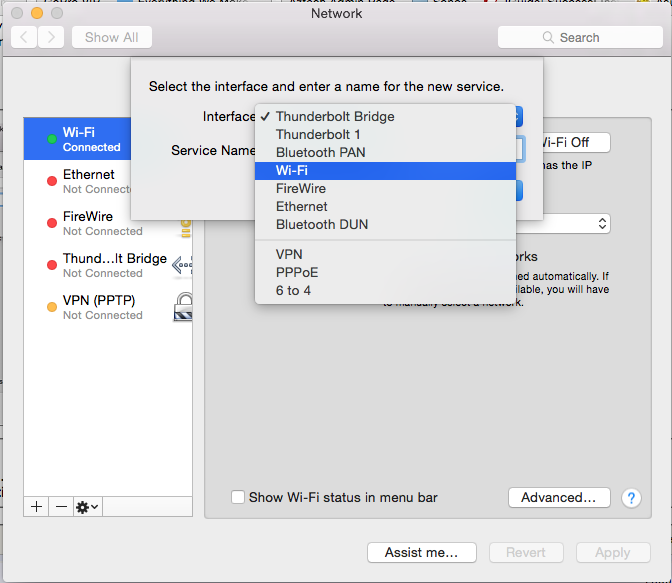

Hmmm... I managed to replicate the same results easily just by removing the Wifi interface in System Preference -> Network.
With that, what happens when you click on the + sign on System Preference -> Network? Do you have Wifi or Airport as an option?

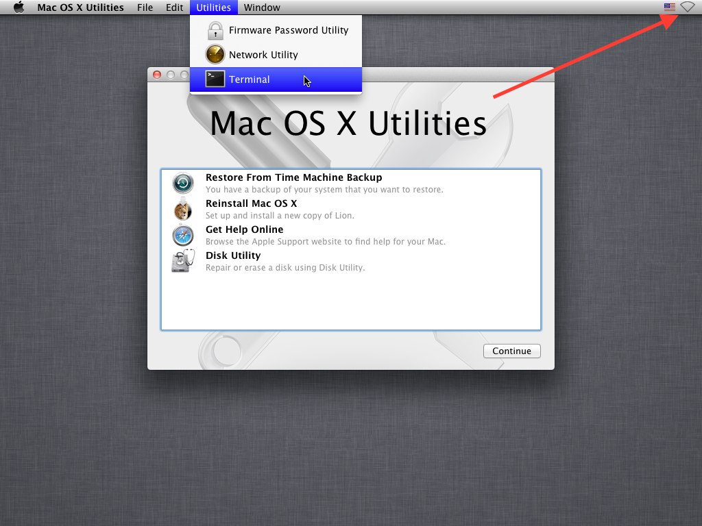

Have you tested in OS X Recovery and see if you can get wifi there?

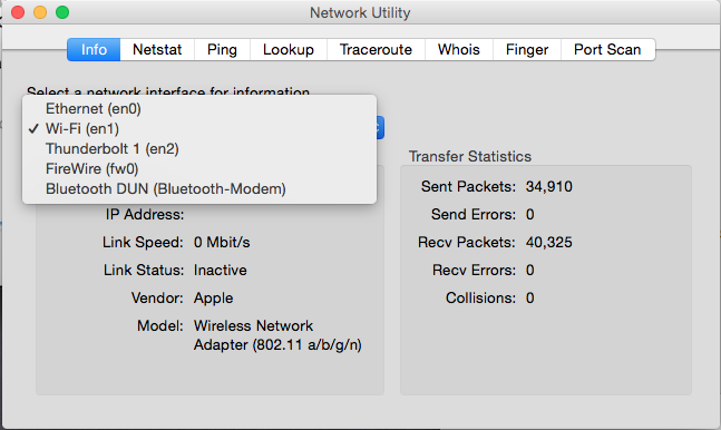

In OS X Recovery, do you see the wifi icon on top right of the screen? and what do you see in network utility in OS X recovery?

If there is a recovery partition you would hold CMD R at boot. If there is not a partition you must make a new USB installer of 10.9 or 10.8.
