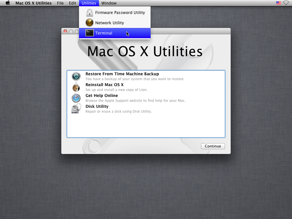

A command-r boot will get you to that same screen you used to install and should look like this. Click Disk Utility and then repair disk to see if that helps.
i done that already yeah, im going to try reinstall once i download to usb. il check disk before install 2. see how it goes.
