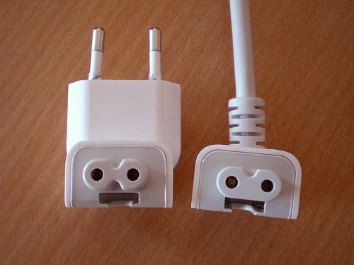

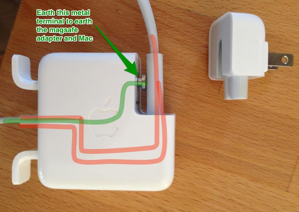

The AC adaptor itself (sans the plug) has 3 contacts, 2 are inside the figure-8 hole are live + neutral, where the exposed metallic disc is the ground. Many people including you are not ware of it being the ground contact since it looks only functioning as a hook for the adapted plug / cord.
When you insert a direct plug onto the adaptor, notice the rails are plastic, so you will never get a ground despite the plug may have a 3rd prong.
If you pay attention, the inside of the rail of an extension cord has extra metallic springs underside, which are wired to a ground wire, which of course goes all the way to the 3rd prong of the other end of the cord.
As far as I know, the only reason of the difference between a plug and a cord has to do with some electricity safety law, because the 110/220v or whatever socket voltage is not yet transformed to much less harmful lower voltage until the power reaches the adaptor brick, therefore the cord and both its ends are deemed dangerous if ungrounded. With a direct plug config this risk is eliminated / minimized.

Does all of apple extension cord has extra metallic springs underside ?
I think so, as long as it's Apple originated then it has to be grounded, unless the cord is localized for specific regions where their wall sockets don't even have ground.
Btw some people use a short wire to achieve grounding. Not sure how safe it is though.
