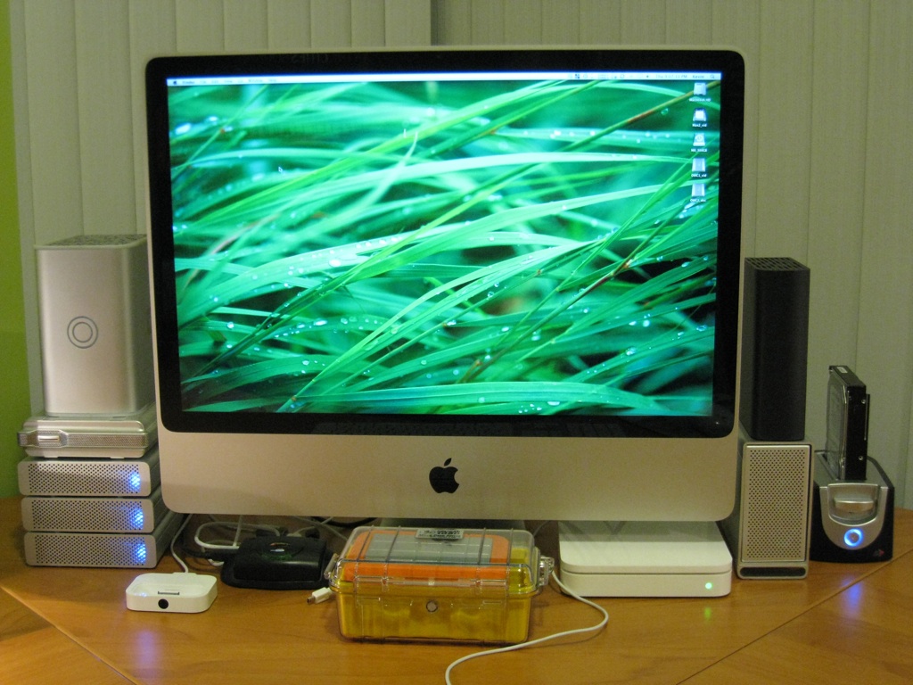

WD Maxtor OWC NewerTech LaCie - you name it, I've used it
Are you saying that you have an external enclosure with the same power supply which can only supply 2A 12V, and have the same Hitachi 1TB drive in it? It is set to spin down when not in use and you have NEVER had an issue where the drive will not spin up?
Maybe its just random luck. It seems pretty clear that the startup power requirements for the Hitachi 1TB drive is well beyond what the JenTec power supply can provide.
I should also mention that the original complaint is against an MacAlly enclosure.
Yes, yes and yes.
Here is my setup:
WD MyBook Pro II dual RAID 0 1TB (FW800)
Maxtor OneTouch II 320GB (FW400)
3 x OWC Mercury Elite-AL quad interface, Hitachi 7K1000.B 1TB (FW800)
WD MyBook Home 1TB (FW400)
OWC Mercury Elite Al dual drive JBOD, 2 x 7K1000.B 1TB (FW800)
NewerTech Voyager Q quad interface for SATA drives (FW800)
LaCie Rugged 250GB (FW800)
The OWC's use the same Jentec 2A power supply. I've had all FW800 and FW400 devices powered on at the same time and no problems, but as I mentioned I don't doubt people can have problems if there is a faulty power supply. I have 2.5" USB hard drives that don't draw enough power from the USB keyboard and makes that clicking sound.
I love the Hitachi 7K1000.B 1TB drives as they have a great balance of low power/noise to throughput. I'm selling my WD and Maxtor units as the drive capacity isn't enough for me. Since I got the Voyager Q I've been buying bare hard drives and store in Pelican cases when not in use.
Looks like the power supply is definitely too weak
