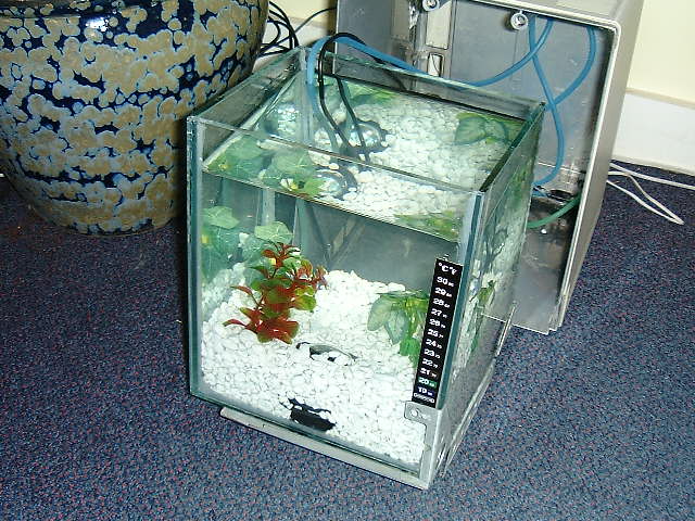

I built one out of an old Mac Plus you can see the photos here http://homepage.mac.com/siami/PhotoAlbum11.html . I put it up for sale on the forums last year https://forums.macrumors.com/threads/160946/ , but got nothing, It is still for sale if someone wants it. I had it sitting in my office all lit up for a while which was pretty cool, but the boss dropped by and took a dim view of it.
If you need some advice on building I am happy to help. The first bit of advice to you is: plan everything properly before you start to cut and dismantle.
Let us know how you are getting on at each stage 🙂

Next bit is the tank, you need to decide on what type of support you are going to use for it as the standard tank design uses flat wooden blocks, were as mine uses the original drive tray which sits at an angle and is not the full width of the casing. I can give you the dimensions for mine if you need them, the dimensions for the standard tank are widely available on the web.

If you want an easy life go with the blocks as they can be easily modified and don’t require precision building of the tank. Using the tray means you have to get the tank built to exact measurements or it won't fit in. Using the tray doesn't leave any gaps in fact the tank fits in with about 1 mm to spare around the top, the screen is completely full of water with no air gaps visible.
My issue with the pump was that it runs on 240V (in the UK) and sits below a large tank of water which can easily be knocked. So I moved it out side the casing just to be safe. Sealing the bottom of the case will be very hard as the space you have to work with is minimal to say the least and you will want to move the tank in and out of the case. A waterproof pump might be the answer if you can find one.

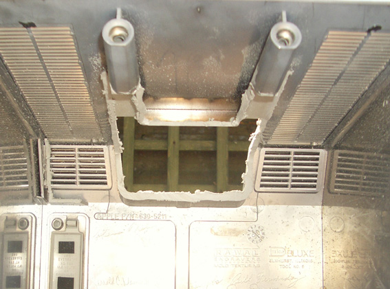

heres the cut (still needs to be sanded )
You can see the handle spot I was talking about in the second picture it doesnt look like you left it in, in yours but I dont see why not, its the same hight as the screw holes.
If its a problem let me know

Did you cut off the front of the metal tray? looks like your did in your picture.
Yep, I cut one side of the front off. If you look at the tray carefully, you will see that it only takes two small cuts to do.
I did leave the handle bit on the same as you, I have cut slightly less away at the back as you don't need to cut it all away. Makes no difference at the end of the day though.
