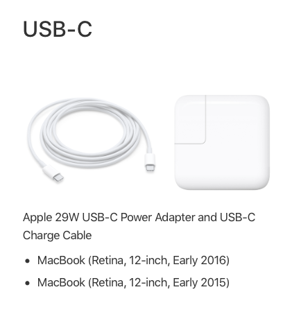

But it says the 29w is the right one?

Well, I stand corrected. I always thought it was 60W - hence most USB-C monitors outputting 60W. Mine also says 29W. Must just be 13" MBPs that take 60W.
