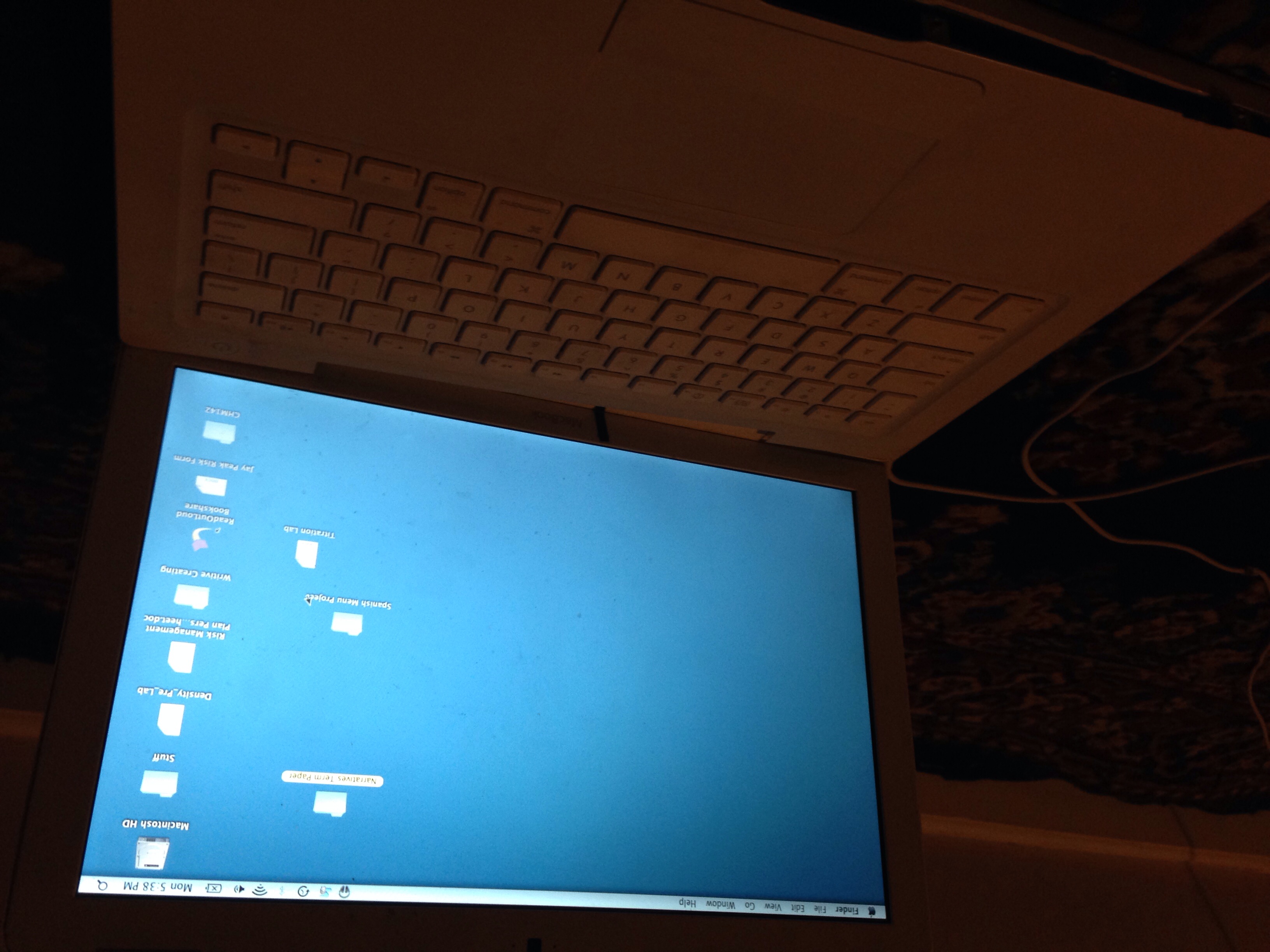

My laptop with my friends hard drive in it. Apparently in safe mode ( shows Apple logo at beginning with spinning loading bar
[[ My laptop with my friends hard drive in it. Apparently in safe mode ( shows Apple logo at beginning with spinning loading bar ]] (pic in post 16)
That doesn't look like "safe mode" to me. But then, I've only had the need to boot in "safe mode" a very few times in the ten years I've been using OS X. I could be wrong.
To me, that looks like a Mac that is "fully booted", in the finder, signed into an account.
The account may be your friend's (and not yours).

Under accounts it's my friends user name. And I'm not booting holding shift button down. So maybe it is nomal and I just can't tell the difference
[[ Under accounts it's my friends user name. And I'm not booting holding shift button down. So maybe it is nomal and I just can't tell the difference ]]
