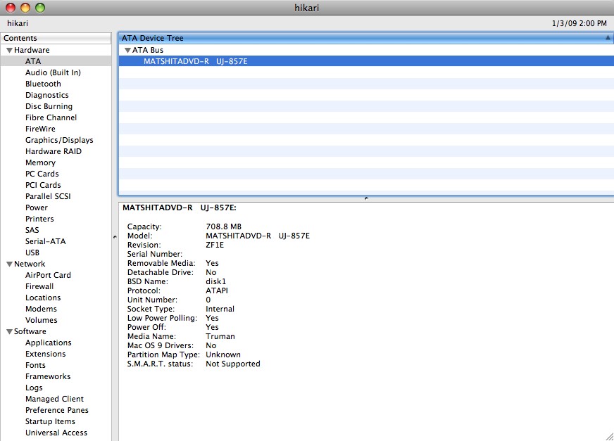

Is it this HL-DT-ST DVDRW GSA-S10N ?
Here is mine under System Profiler.
