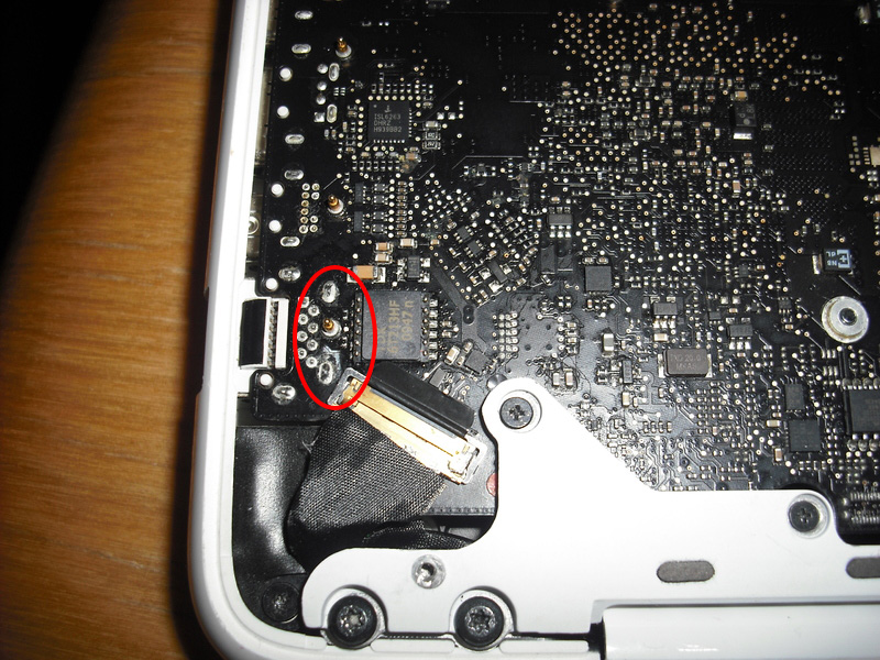

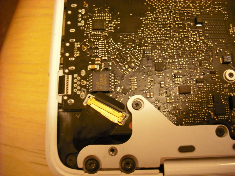

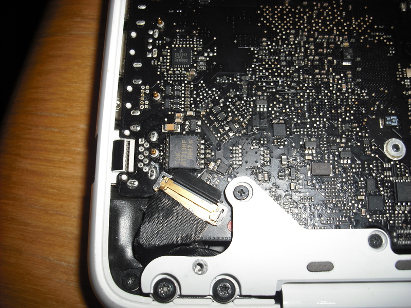

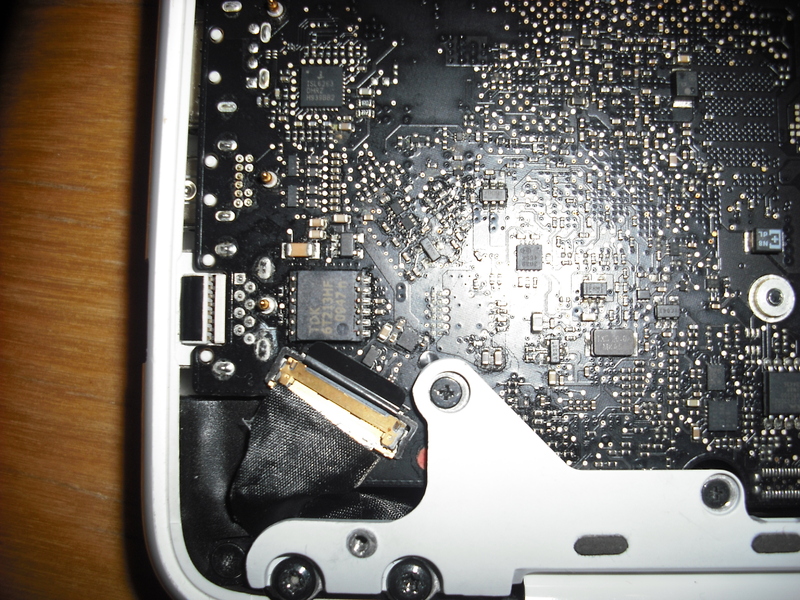

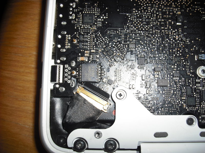

Not sure if these are any help to anyone

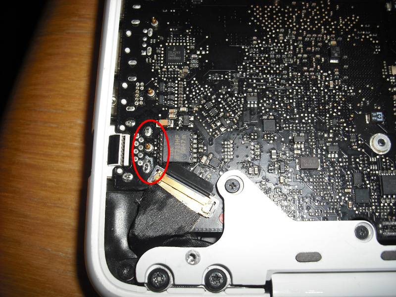

The problem is in the red oval - looks like liquid damage from here

I assumed so because the white doesnt look very normal. I had ringed this in another picture but didnt post it. I tested over two of the contacts and got continuity, any other tests I should be doing or any ideas if that is repairable
Also the network port and magsafe connector work fine
