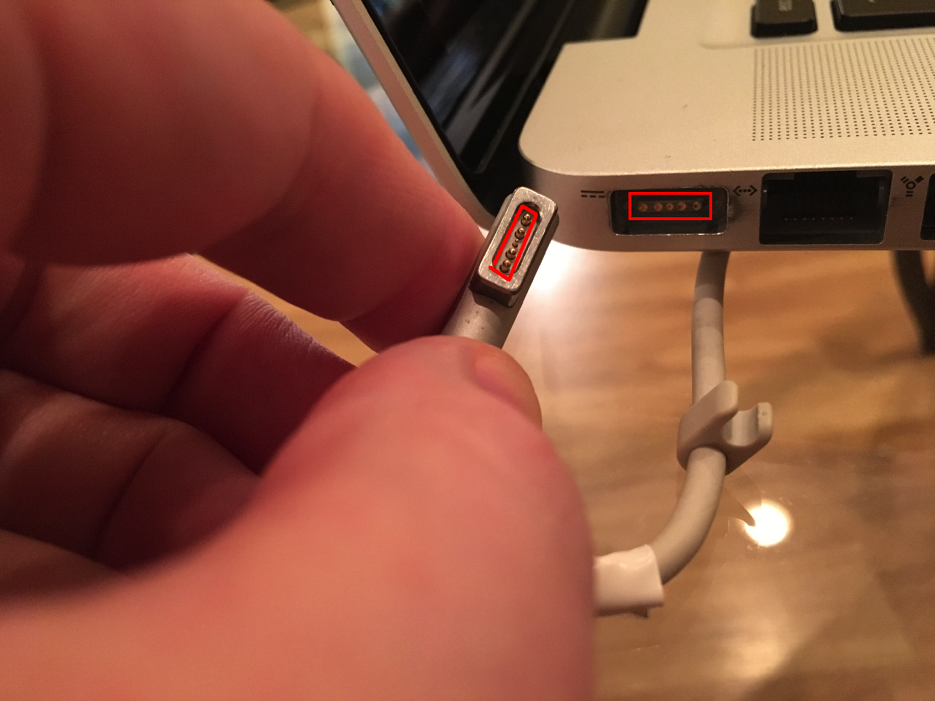

If you haven't already, you may also want to check the port and the MagSafe connector to see if there's dirt or something inside. May need careful cleaning.

Not inside the case, but in the MagSafe port and the hollow space in the MagSafe connector. If you look, you'll see where dirt or other things can collect and interfere with the connection. (It does have a MagSafe connector, right? The kind that connects with magnetic force.)

Sanpete was referring to these areas, the contact areas on the plug and directly inside the port (not the board inside the computer.) I agree checking for any oxidation and cleaning this is a great place to start...I generally use a dry soft bristled toothbrush. I also agree with trying another power cable. If you have not already, for good measure it may also be worth resetting the SMC & the PRAM.
