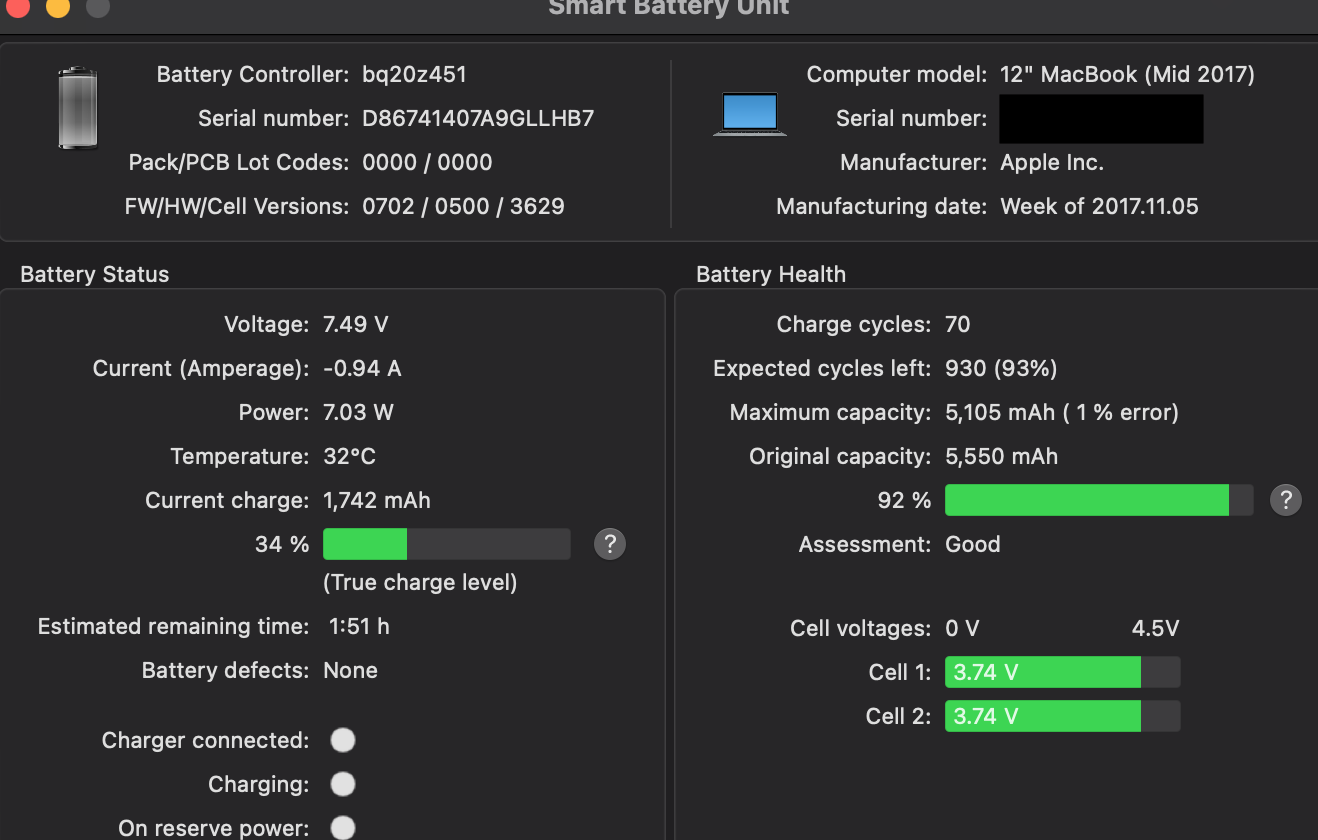

Assume you are looking at the Apple health number, not third party like Coconut? It is certainly normal for third party values to go up as well as down.
If it is the Apple value and the capacity value is going up and down I would suspect a cell dropping out maybe.
The third party battery app Battery Monitor by Marcel Bresink reports individual cell voltages so might be worth trying

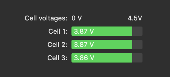

Thanks, I am testing it. I use Battery Health-2, Coconut and also Apple readings. I bought the utility Battery Monitor and it does show by cells the battery condition. It gives reading of 92%.
Are all three cells the same voltage (as my screenshot) ? My thinking was that next time you see surprise dip, look at the cell voltages....is one lower than the others? Does it recover? would indicate a dodgy cell.
yes, but there was reading from two cells.
