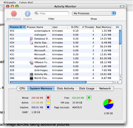

Thanks for the answer. I thought that they might have some processes to match RAMs with exact the same value or something.
633.64 for green and 936.91 for blue.

As I thought. More memory didn't really help you. If you run something like iMovie or startup a lot of Dashboard Widgets, you would have noticed the difference.
I did run something like VMWARE or Photoshop but the speed is the same as 1GB (from my feeling). When I was running VMWARE, there were no green area at all.
