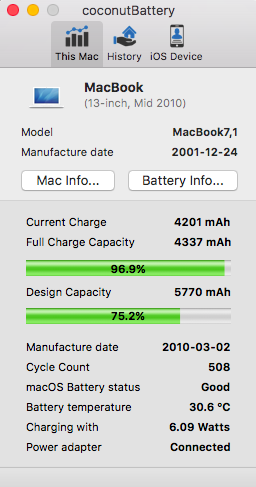

After reassembly I downloaded the Apple EFI update tool for this model and ran it, and it said "This software is not supported on your system." In parallel, I had downloaded and ran the latest Coconut Battery, which reported over 75% original capacity( on a ten year old battery!!!) but also that my mid-2010 macbook was apparently manufactured on 2002-01-07. It's no secret that Apple and Apple specific (endorsed) developers like to end support for their software on older hardware even before it's physically unsupported, so no surprise I can't download or update a single app through the Store, nor will the EFI Update .pkg recognize mine as a system made in their predefined allowable date range. I thought this might be something to do with having a 10 year old CMOS battery and not being powered on for several years, but what I realized next was kind of strange, to me.
Over the past few days of using it to make sure it's stable otherwise, the manufacture date is actively rolling back further. Now it's back to 2001-12-24. That's ~2 days regression for each day I've recently had it running.

This is most likely a bug with Coconut Battery, talk to the developer if this bothers you. How does the machine function otherwise? Also, try another program and see what date they report.
The manufacturing date you see in Coconut Battery is not something that's saved in the computer itself– it's just the app itself that's doing the reporting based on a guess derived from the serial number.
Coconut has been the go-to for this kind of info afaik since I had an iBook g4. It's usually right, and was right back when I frequently used this system. I don't have the original date memorized, it's been a while, but it was definitely around the same as the battery (march 2010-ish) macOS system report shows the battery info and date as well, but I can't find anything about the logic board/system itself. Function wise, nothing that talks to apple servers works anymore. App store asks for my ID and says i need to review terms, then freezes on a blank screen. FaceTime does the same thing more or less. System updates say they're downloading but have made no progress over the past week on our 150mbps service, so obviously they're hanging too. And like I mentioned, the EFI update package that was downloaded from Apple for this exact model says it's not supported on this hardware, so I'm stuck with 2gb of RAM. less than ideal, even for basic kid tasks in 2020.
I just mention Coconut because it's what made immediate sense as being related. My real issue is not being able to run the EFI update package for macbook 7,1... on my macbook 7,1

The EFI is updated now in system software updates. The latest High Sierra security update will have installed the latest possible firmware version for that computer, so the update you're trying to install has probably been made obsolete. What operating system is on that computer now?

No, the build date as reported in Coconut Battery has no function with regard to the computer's operation. That's purely a function of hardware model/firmware and operating system version.

I've had issues with the manufacture date of my 7,1 using CoconutBattery since the latest update. It's always shown as 1/24/2011, which jives with when I purchased it, but in the latest update it switched to sometime in 2001. The patch notes mention that they changed how the manufacture date is found. I just rolled back to an older version for now.
