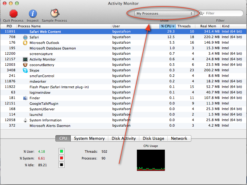

Have a look at Activity Monitor (Applications / Utilities /) and select All Processes and sort by CPU to see what the culprit may be.
image below uses sorting by CPU as an example

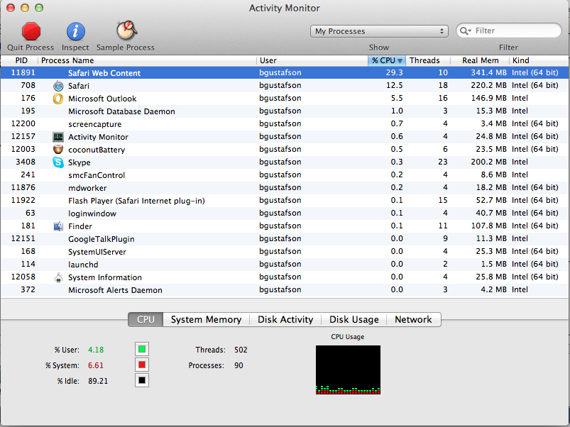

I did that, nothing more than what I posted above.
Two things I see in there:
1) Skype is running and on your MBP it will force the use of the dedicated graphics which will reduce your battery life.
2) Flash is running on your Mac. Flash is, always has been, and always will be a battery killer.
Both of those are addressed by the tips in the Battery FAQ I posted, using gfxCardStatus and ClickToFlash.
