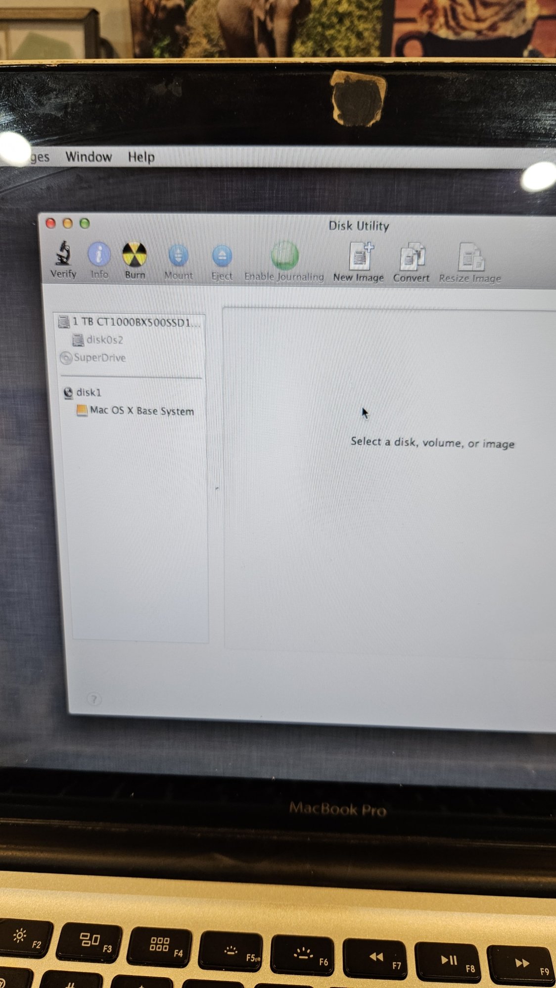

I started from internet recovery and went into disk utility
The first time I tried this verify disk was greyed out for all the different drives in the left column, then on the second boot into recovery I could verify and repair one of them ( cant remember which exactly now) but it still didnt boot

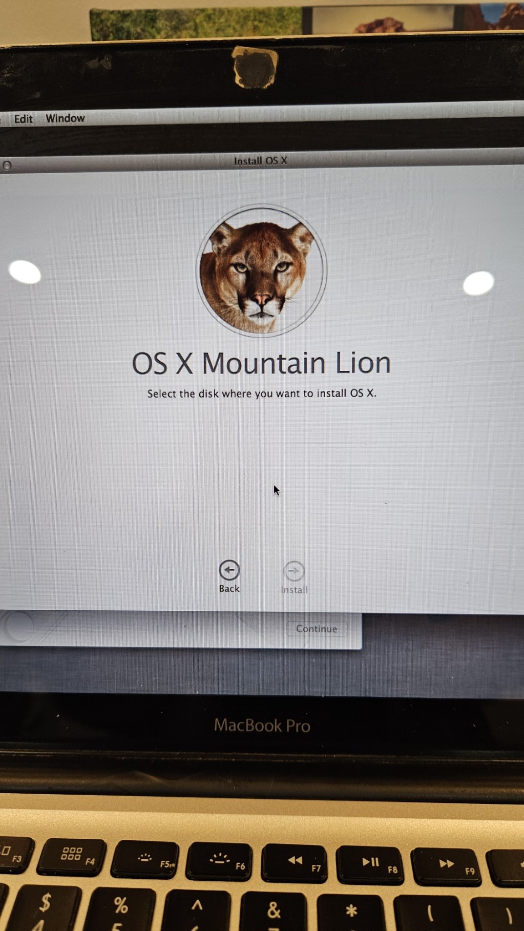

Went back into internet recovery and went to install OSX, I click through and eventually see this screen
It doesnt find the SSD.

I suspect that your mum's SSD was using OSX 10.15.7 (Catalina), therefore formatted as APFS. That would explain why it could see the files on that drive when connected to your M1 Air (running a newer version of macOS) and why it would NOT see the SSD when on a system booted to Mountain Lion (which can't see any kind of APFS volume, just an un-recognized device. Mountain Lion doesn't understand what APFS is. If you try to install Mountain Lion anyway, and the SSD works at all, it will likely throw out an error immediately, something like "unknown error" or similar. And, you can then erase the drive to change to a known format for Mountain Lion, which will leave you with nothing except a system, all existing files erased.

The A1278 (13-inch MacBook Pro), shipping from early 2009 to late 2016, probably never shipped with Mountain Lion, although individual MacBook Pros may have been updated at time of sale. If you see Mountain Lion when booting to Internet Recovery, then that just means that Mountain Lion is the oldest compatible system that is still available to that MacBook Pro.
And, yes, Mountain Lion cannot read a drive that is formatted APFS
(note: There was also a MacBook A1278 (called a Late 2008 Aluminum), and I thought that was what this thread was asking. But, I see in OP's first picture that is a MacBook Pro, not a MacBook. So, 1 of 5 MacBook Pro A1278 models, with the 2012 model being the last Mac sold new with a built-in optical drive.

I think I'm getting somewhere now, I did Command, Alt R on startup and it did internet recovery with Catalina and then from Disk utility I ran First Aid but it said "File system verify or repair failed: (-69845)" and it Unmounted the disk, then when I tried to Mount it again it failed
Going to backup the disk and check for errors
