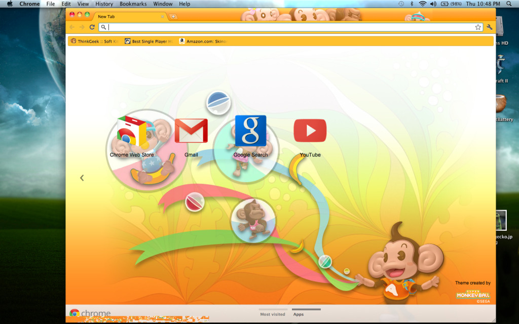

So i was watching tv today and my mac was sitting on the table, and i noticed on the screen saver the screen was just flashing very fast, when i went to wake it up it got brighter continuing to flash but would not respond. i was forced to turn it off by holding the button down, after that it would not boot. got to the spinning wheel and the wheel froze, after going into single user mode and doing a check on the disk which found no problems, it booted up but once in it froze for a few seconds, then the screen began flashing and then random glitches with the screen began, as can be seen on the photo i will attach. and the screen is continuing to flicker and stuffs showing up weird. is my mac finally kicking the bucket? oh also the glitches on the screen seem to relate to when the computers doing work, not when actually touching it so it doesnt seem to be a bad cable to the screen.
It seems like there's a problem with the graphics chip. The only real solution is to take it to be checked by Apple.

What version (i.e. Spring 2010 or ???) is your MBP?
FWIW, there is a known issue with some of the Spring 2010 15" (and perhaps 13" and 17") MBP. The problem has to do with the nVidia graphics chip being faulty. Apple is offering to replace the logic board on these.

Its a older one probably over 4 years now
Let me guess. It has a Nvidia 8600 GT GPU? If that is the case, go to the nearest Apple store as soon as possible. There is an extended warranty replacement program for those GPUs, however it's only for four years since purchase.
^^^ This. You might be able to get it replaced for free if that's the problem. Even if you're past the 4 years, if it is the Nvidia issue, I'd take it in anyways. You might get a genius that's nice enough to still get it fixed for you.
yep your right, i just got home and was able to get it to power up and thats the card, im gonna go first thing tomorrow. im really hoping they do, i just got my hours at work severly cut, so i cant afford to fix the laptop on my own 🙁
