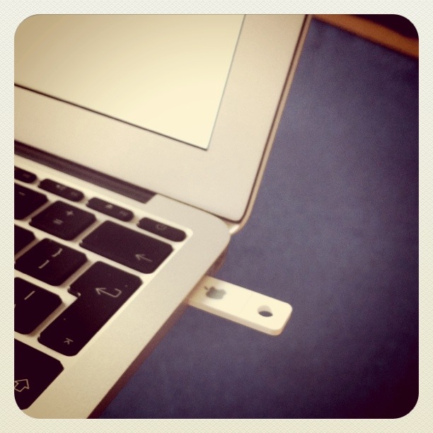

Update:
Before booking to see a Genius, I thought I'd try reinstalling OSX breaking out the little USB reinstall drive and doing a full reinstall.
After reinstalling everything and getting all the software updates sorted, I left it to sleep when I went to bed...
In the morning, as soon as I opened the lid, it woke up! So it's working again.
Very strange but at least it's working now!
