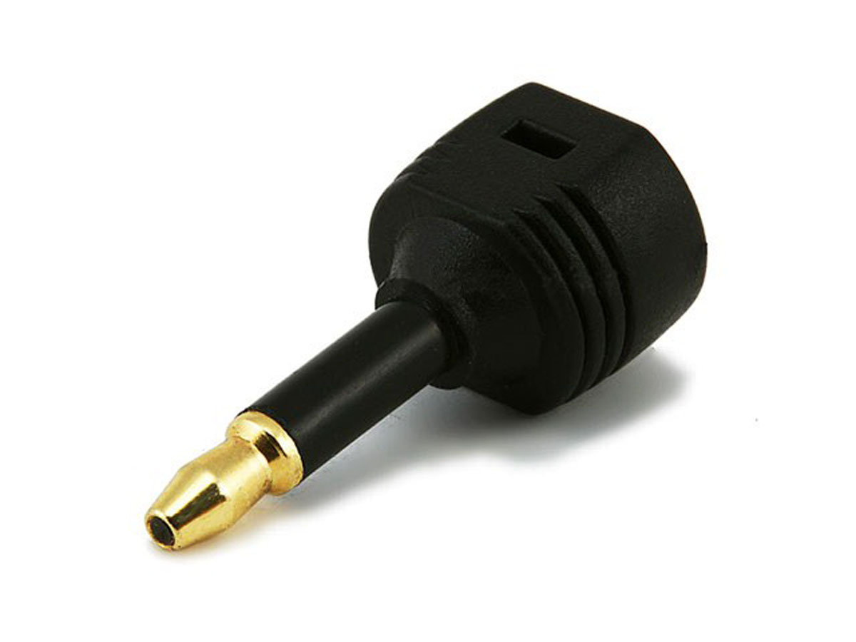

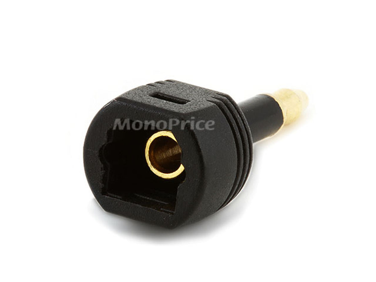

    I have a Headphone jack to FiberOptic convertor for my MBP13 and it fits and works perfectly. However, when I use it on the MBA 13 it doesn't fit in all the way (that's what she said ;p) so that leads me to believe it's a different size. Can anyone recommend me a different headphone jack to fiberoptic audio convertor so I can use on my sound system please? Any help will be greatly appreciated. Thanks! :)
    This is what I am trying to use:
    Toslink Female to Toslink Mini Male Adapter
    http://www.monoprice.com/products/p...=10423&cs_id=1042301&p_id=2671&seq=1&format=2
    [​IMG]
    [​IMG]

    A toslink connector would only fit properly if the audio out supported digital audio out. Apple's tech specs page for the Air says nothing about digital audio through the audio out jack, while it does say digital audio out for the Pro.
  10. phantax macrumors member
    Joined:
    Feb 2, 2009
    #10
    The audio out / headphone jack on the Air is analog only. You can get digital audio through the Mini Displayport with an HDMI adapter or by getting a USB audio interface.

    Precisely my point. The OP is trying to get digital audio out of an analog output jack, unsuccessfully of course, and trying to force the toslink connector into a jack that isn't made for it. Even if the toslink will seat properly in the jack, he's not going to get any sound through it.
  12. phantax macrumors member
    Joined:
    Feb 2, 2009
    #12
    Yah sorry, meant to quote the post above yours.
    OP, if you absolutely need optical audio only (not digital audio over HDMI), look into the Turtle Beach Micro II. It runs about $25 USD, has OS X drivers, and is very small and portable.
