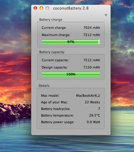

where can I see cycle count and capacity? Got my MBA on saturday 🙂 best electronics purchase I've made so far
There is a free app Coconut Battery that will show you.

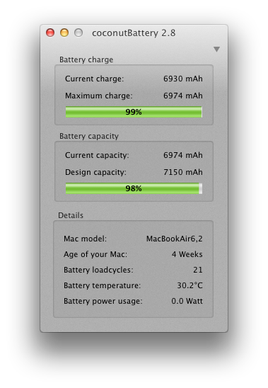

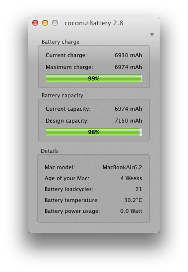

Mine is up and down (as normal I think):
It started dropping from a steady 100% at around 38 cycles.
