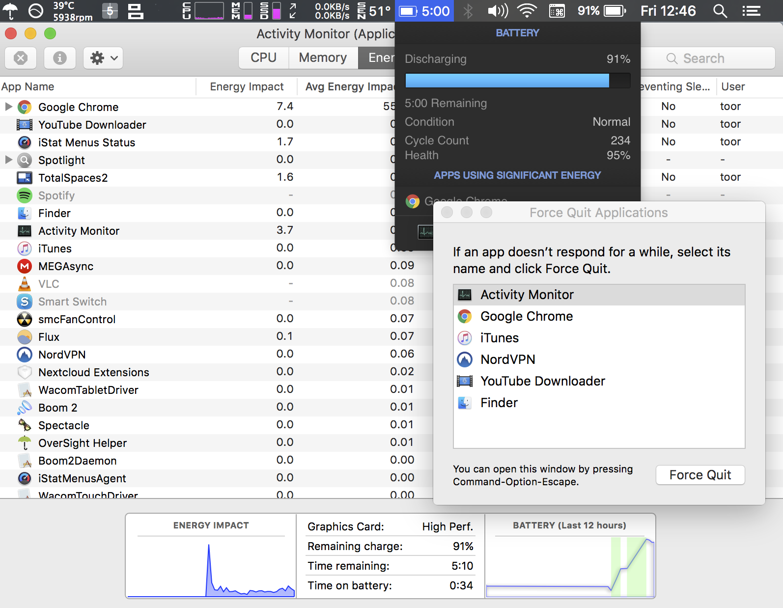

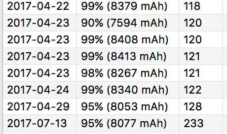

Had the same thing here with a battery for a 2012 retina MBP bought from ebay, you're fine as wine😉
Here's the coconut report ^^
It's funny because this usage is worst case scenario, this laptop draws 16-20W at idle & much higher usually!
Also found charging with 60W adapter while sleeping instead of the 95W or so helped increase back to ~98%
(if on it draws ~16.4V instead of ~19.5 so only been doing that while turned off/sleeping)
ps. I still get 5-7 hours with this thing idleish, screen low, etc
time to move over to a 2015MBA!

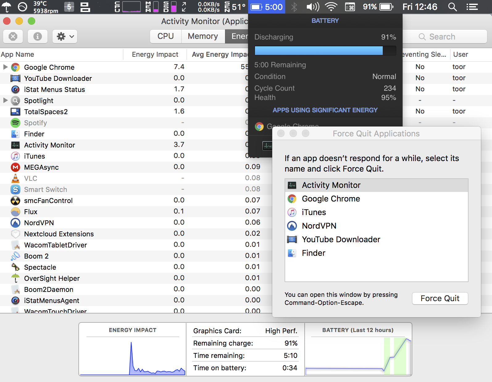

One thing- if you don't mind me asking, what are you doing on your Air to get 5-7 hrs run time? Are you using it constantly? And are there any settings or tweaks that I could try that you have done with it?
Thanks,
Alex
ok, cheers.
Thanks,
Alex

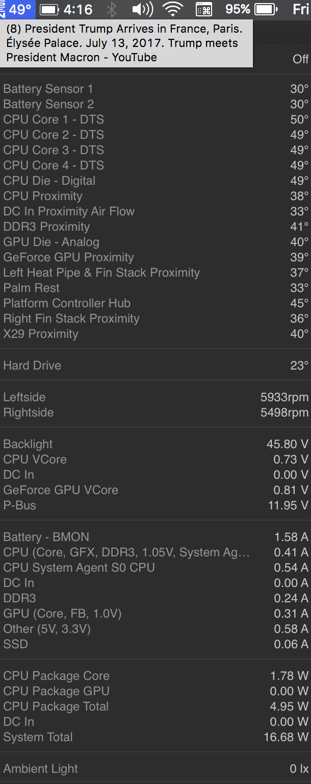

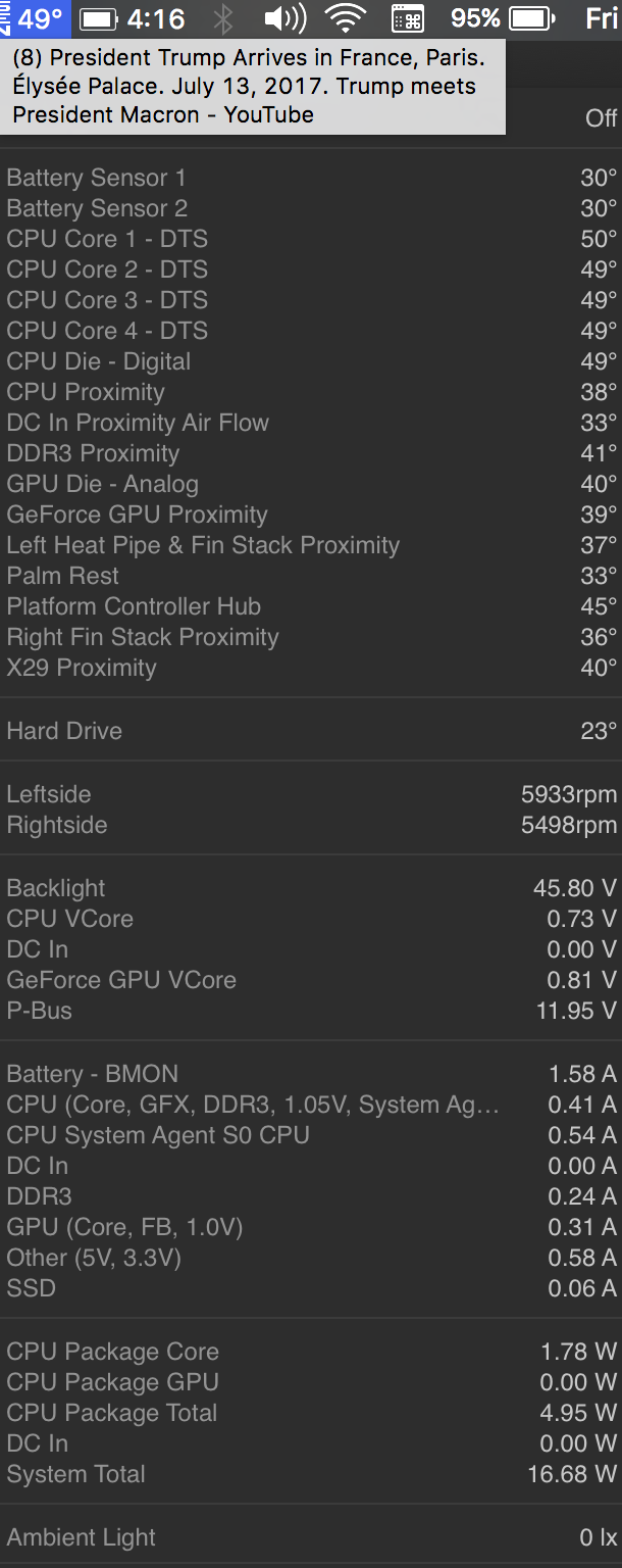

It's a retina macbook pro 15" 😉 the 2015 Airs consume like ~5W idle and give you around 10-20hrs eaaasy
only tricks I got are pay attention to BT/WIFI when not in use, lower brightness & most of all..
..increase fan speeds enough so your laptop is chilling around 30-50 degrees C (less power wasted as heat)
The fan speeds on mine are both maxed at 5000+ RPM but still getting 5+hrs with the old power-hungry dGPU
View attachment 708554 View attachment 708555

that looks like some nice programs you've got there for monitoring everything lol.Any chance you could tell me what they are so that I could download them for my Air?
Am amazed that at over 200 cycles your battery is at 95% capacity, u must charge it very carefully. Is it the original battery in there from 2012?
