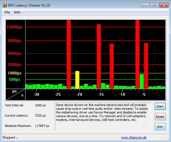

Hi,
I've installed Win7 64bit using Bootcamp on my MacBook Air (2009 model).
The installation went through without any problems. I then installed Bootcamp 3.0 from the Snow Leopard CD and then Bootcamp 3.1 using Apple Software Update.
Everything seems to be working fine (sound, wifi etc).
However, whenever I start to work with the computer (open some application, compile some code etc) I get some random stuttering where the whole computer seems to stall for half a second or so. It's especially noticable when I'm listening to music.
After some googling, everything points to a bad driver. Running the DPC Latency Checker program supports this theory (see attached screenshot). Whenever the computer stutters it records a big red spike.
I tried to disable any device in the device manager I could think off (audio, wifi, bluetooth etc). Nothing helped.
I think it's got something to do with the SSD since the spikes are the worst whenever it loads something from the harddrive.
This is starting to drive my crazy, maybe someone here has any idea. Any help is greatly appreciated.

Win7 64 Fix for Stuttering Audio and high DPC's!
I had the same issue, and I ran the DPC latency checker and found extremely high DPC counts, which will always cause stuttering/dropouts.
Turns out another gentleman has already figured out the issue (Thanks T1mur!!!), which has mainly to do with the bootcamp.exe process being poorly written for symmetric multiprocessing.
Read this thread for the fix and discussion: http://discussions.apple.com/thread.jspa?threadID=1876027&tstart=0
To cut to the chase, just download the "bootcamped" scripts that he's posted, available here: http://www.screencast.com/t/7HhqtFZLpf
If you're running Snow Leopard and have the latest 64 bit bootcamp installed, you'll have to make a few changes to the scripts. The scripts all point to the process named "KbdMgr.exe" but in the latest Bootcamp it's called "Bootcamp.exe". You'll need to change every instance of the former and replace it with the latter (an easy way to do that is to open them all in Notepad++ and use the "replace in all open documents" function) and run the script "Start Boot Camp.CMD" This script just tweaks the bootcamp.exe process priority and affinity for one CPU, causing it to behave. If you run DPC latency checker and keep it running while you start the script, you will see an *instant* improvement!
This is the best option for anyone having this problem with Bootcamp, at least until Apple decides to fix their drivers.
