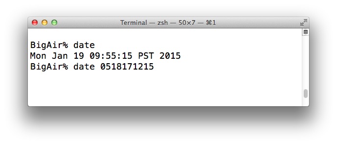

Well I finally got Lion installed. I tried backing the time and date to 2011, but didn't work. I stumbled upon a YouTube video that led me to a website that had .dmg of older Mac OS. He created a bottle USB stick with Windows and then used a program called TransMac to make the install USB.
