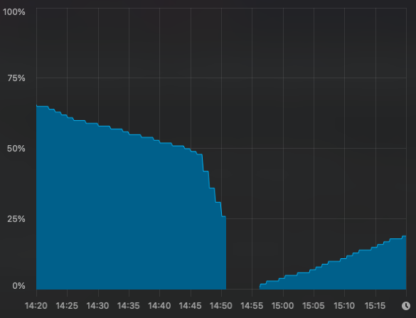

Recently swapped out the battery in the laptop for a third-party solution, the one in it before was also a replacement not made by Apple. Everything seemed fine out of the gate until the battery ran out in a peculiar way - once percentage hit 50%, it started dropping 10-20% per minute and turned off at 12%. After turning off (presumably the battery had discharged by then), the laptop doesn't boot but gives out 3 recurring RAM failure beeps at boot attempt.
I've attached a battery percentage graph to better illustrate the drop.

After replacing the battery, did you perform a calibration?
I thought I did. I didn't exactly pay too much attention to how long the "rest" times were. Is it really possible that a bad calibration could be the culprit? If so, my battery currently shows 5 cycles, can it still be calibrated properly?
Sorry for the long wait.
Battery calibration did actually end with me being able to boot up the Mac normally after it had been out of battery overnight. It booted up the next time as well, but the third time it ran out I had to reset the SMC again, which (as much as I understand) reset the power management settings so now, again, the laptop turns off at roughly 40% and beeps every single time I try to boot it.
Frankly, I'm lost 😅 I can still continue using the Mac normally and now just have to think about the fact that when it shows roughly 50% battery, I have to plug in the charger. I've set my battery warning to 50% for the time being, so I don't forget and possibly lose any files I'm working on in the meantime, since it does basically hard-reset every time it shuts down and shows the "your computer shut down due to a problem" notification once rebooted.
Are there any other things I could try before I give in and probably just keep it plugged in all the time, whenever I use the laptop?
