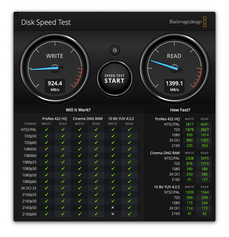

I installed Catalina on the SSD and ran the Blackmagic Disk Speed Test benchmark. Initially, the write performance was really low (even as low as 10MB/sec), while the read speeds consistently reached 1300MB/s+. I had seen similar poor performance before with aftermarket mSATA drives in some of my other Macs, so I tried to remedy by enabling trim support via the command `sudo trimforce enable` and rebooted the MacBook Air. Re-running the test now shows 900MB/s+ write speeds and nearly 1400MB/s read speeds!

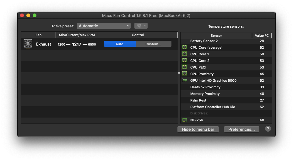

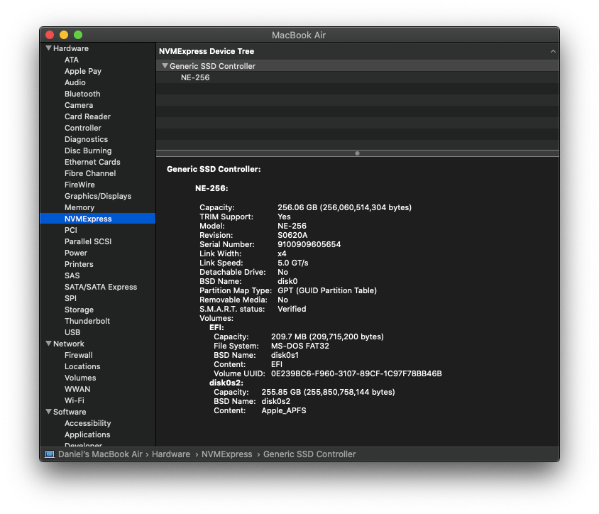

The NVMe SSD is recognized by System Profiler with a Link Width of x4 and a Link Speed of 5.0GT as expected. Macs Fan Control shows the KingSpec SSD running cool around 40°C. I have not seen the SSD temperatures rise above 50°C even during post-installation indexing and benchmarking.

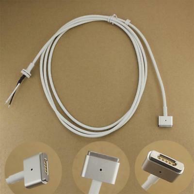

Because most of my Macs are quite a bit older, I also didn't have access to a MagSafe 2 power adapter (and didn't want to pay $20 or so for a little MagSafe 1 > 2 converter which will likely go missing). So I bought a MagSafe 2 cable (only) for about $5 AUD. After carefully cracking open an existing 60W MagSafe 1 power supply (of which I have many) I desoldered the original cable, soldered on the replacement and re-sealed the plastic housing seams using the soldering iron tip. Instant Magsafe 2 on the cheap!
I've now ordered a replacement 55Wh 7.6V non-geniune battery from an interstate supplier for $65 AUD (inc shipping) to bring it back to it's portable glory. This should arrive during the week.
