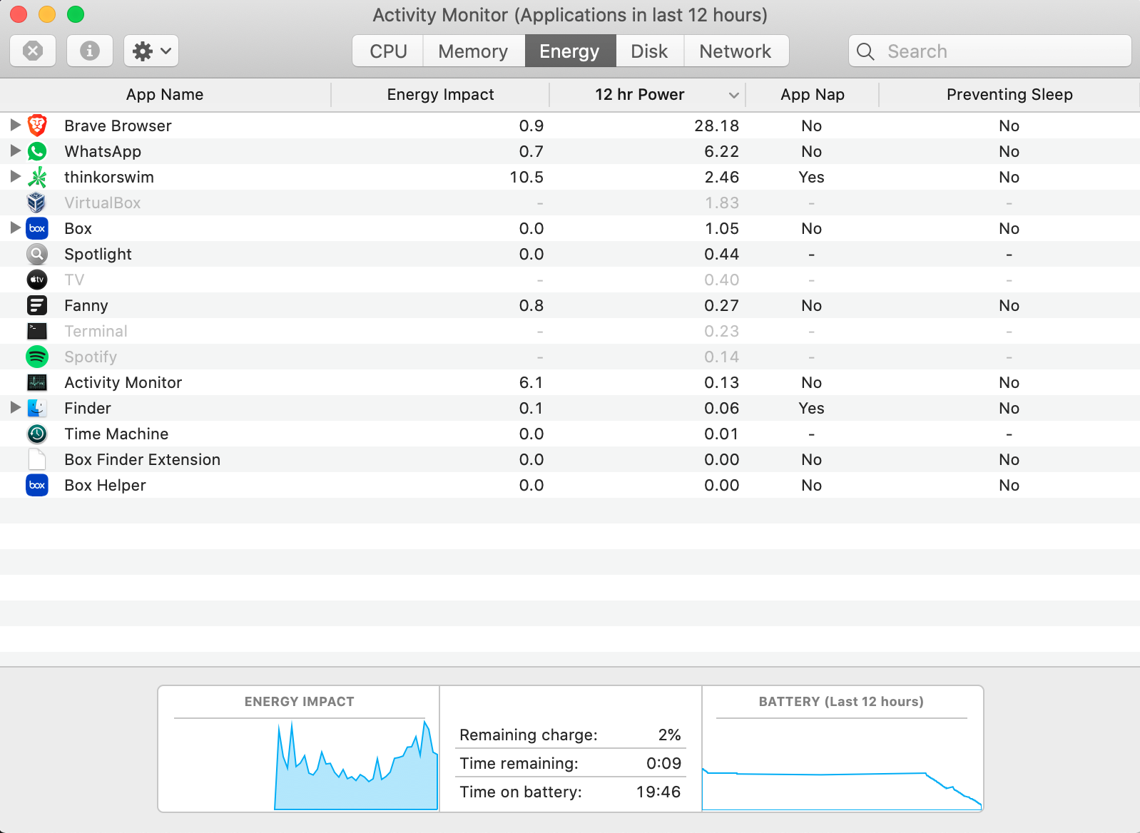

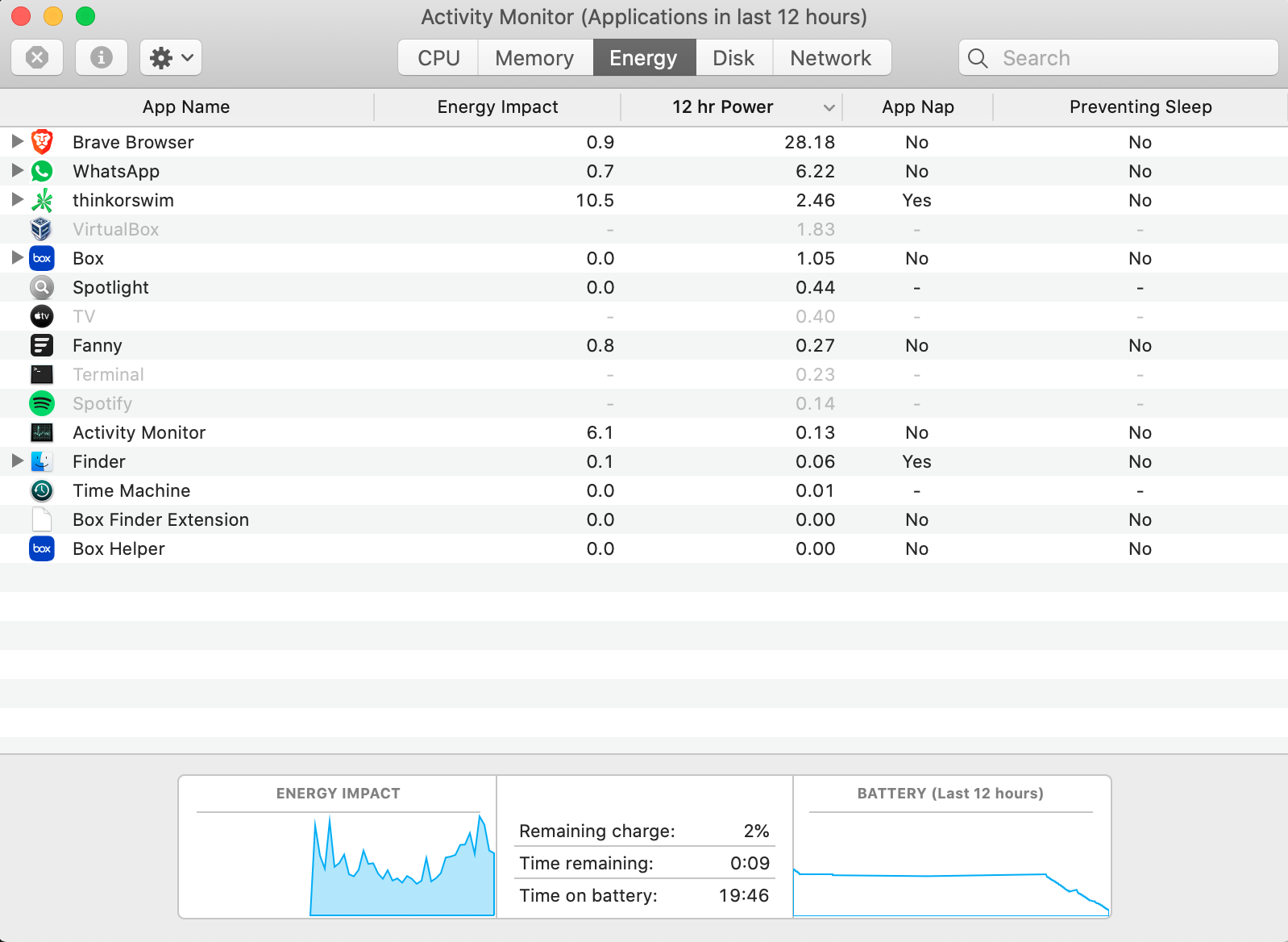

Battery seems to be very good for medium-heavy load and its better than my surface laptop 3. In the picture below you will see duration of 19:46 on battery and approx. 9:30 it was in sleep with lid shut down. That gives me approx. 10 hours of usage. What you don't see in picture below is python log scraping application which did lot of I/O on a 50gb file and drained 10% battery in 30 minutes.
EDIT: This is on i5/16gb/256gb/SG config.
