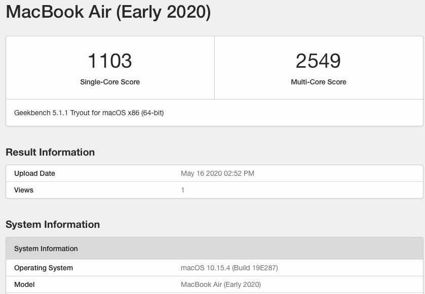

Want to share my benchmark result with Geekbench 5, this is with limiting the turbo power and normal power to 16W and 8W using voltage-shift.

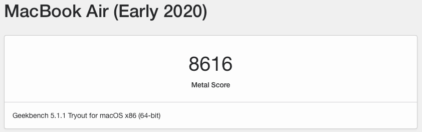

Below is metal score
It seems the performance impact is minimal (about 100 points lower for multi-core but I've got higher single-core) when comparing to below result:

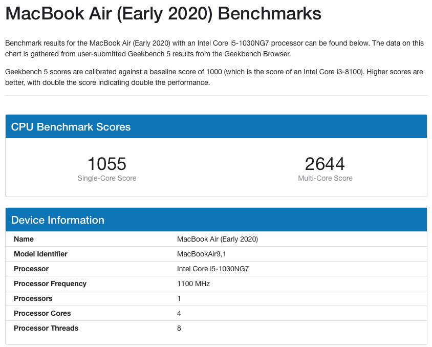

And if I compare with other benchmark:
My result seems to be inline with the other i5.
My MBA is silent during the benchmark I couldn't even hear the fan, so using voltageshift to reduce the heat seems to be successful for me.

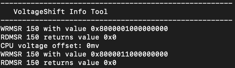

./voltageshift info
You will be asked to provide password as it need to run as root / admin.
If all well you should see the information like below:
And will be able to see the power information at the end:

9. After executing the shift.sh you can check the setting by running the ./voltageshift info and should see:
