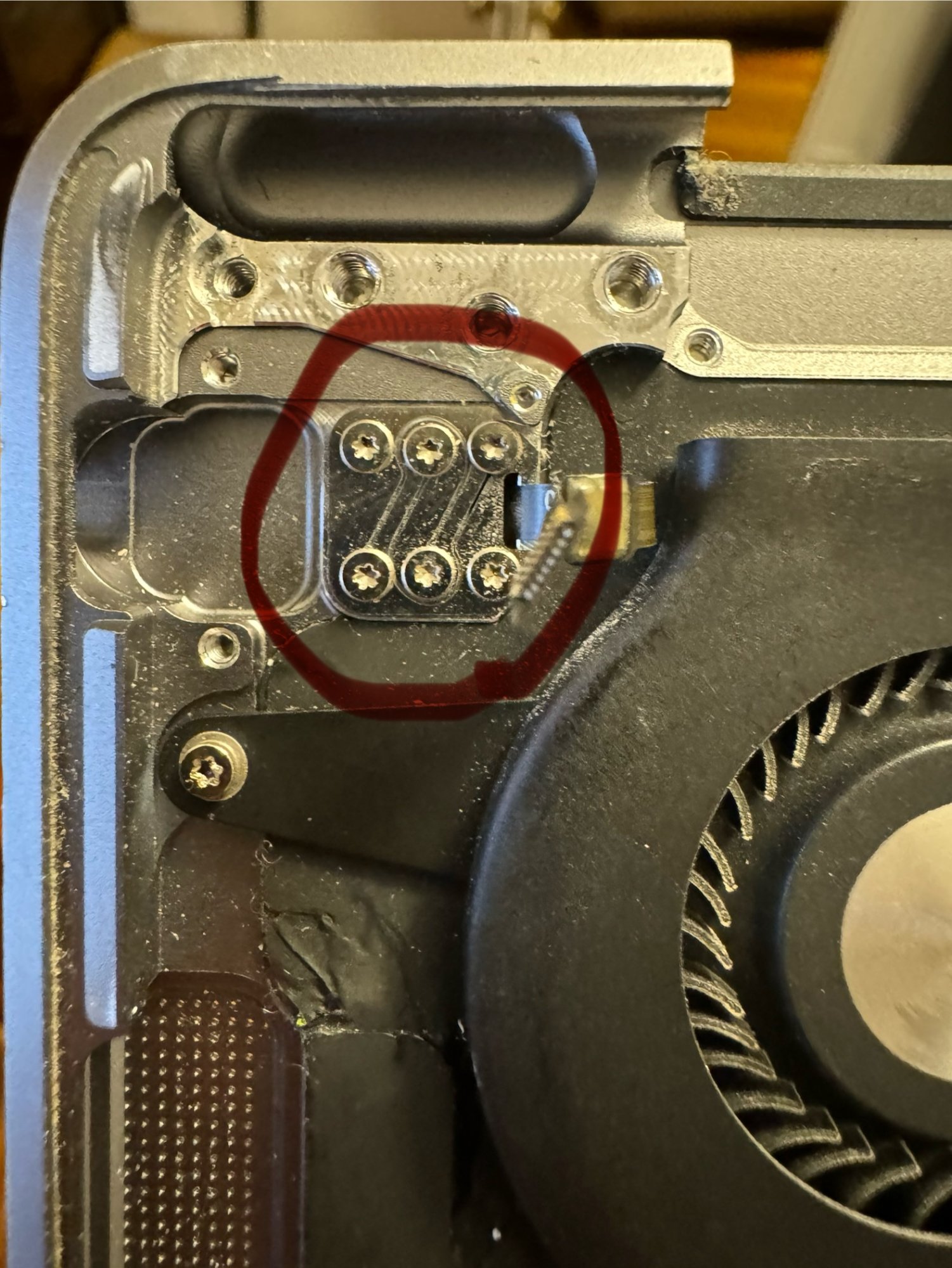

Thank you iStorm. Perhaps a dumb question, but if I still have the original Touch ID sensor from the broken keyboard. Do you think it could be possible to swap it out with the one from the replacement keyboard? Or does it go deeper than that?

Good question, I think that would work!
According to the self repair manual for the 2020 MBA (they don't have one for the 2019 MBA), the Touch ID board and keyboard are two different things, so I don't see why swapping them wouldn't work.

Wow. Let’s hope it does! I’m bringing it back to the repair shop tomorrow and we’ll see if they’re game to try. I’ll report back. Thanks again.

Update: That was it! Put the old button back in and she’s back to normal. Thank you.
