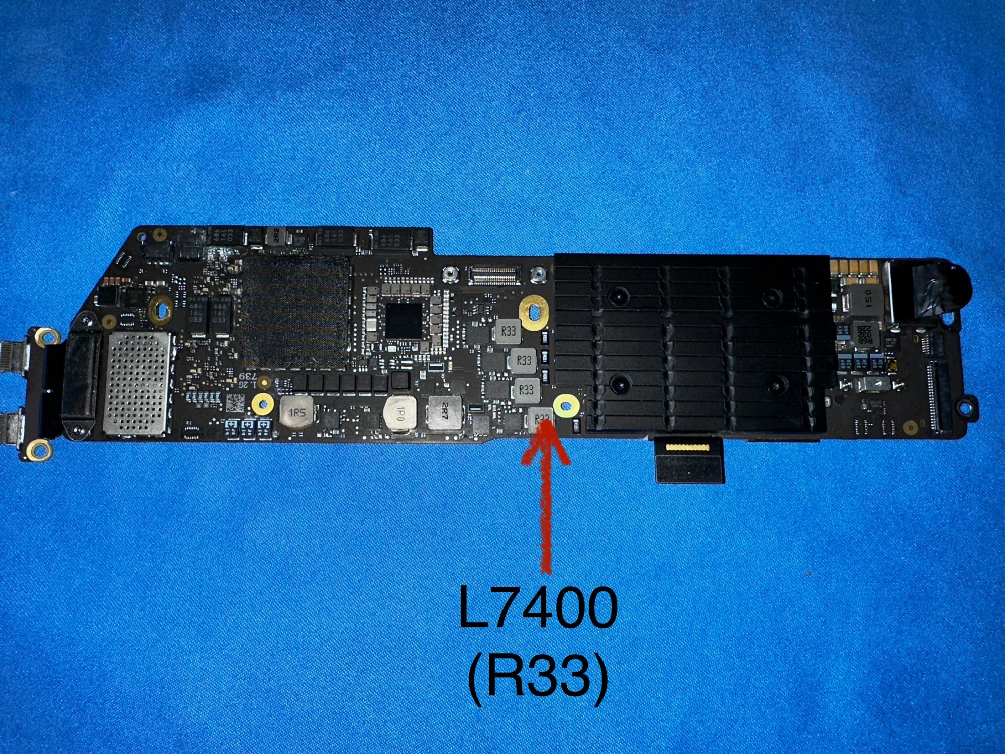

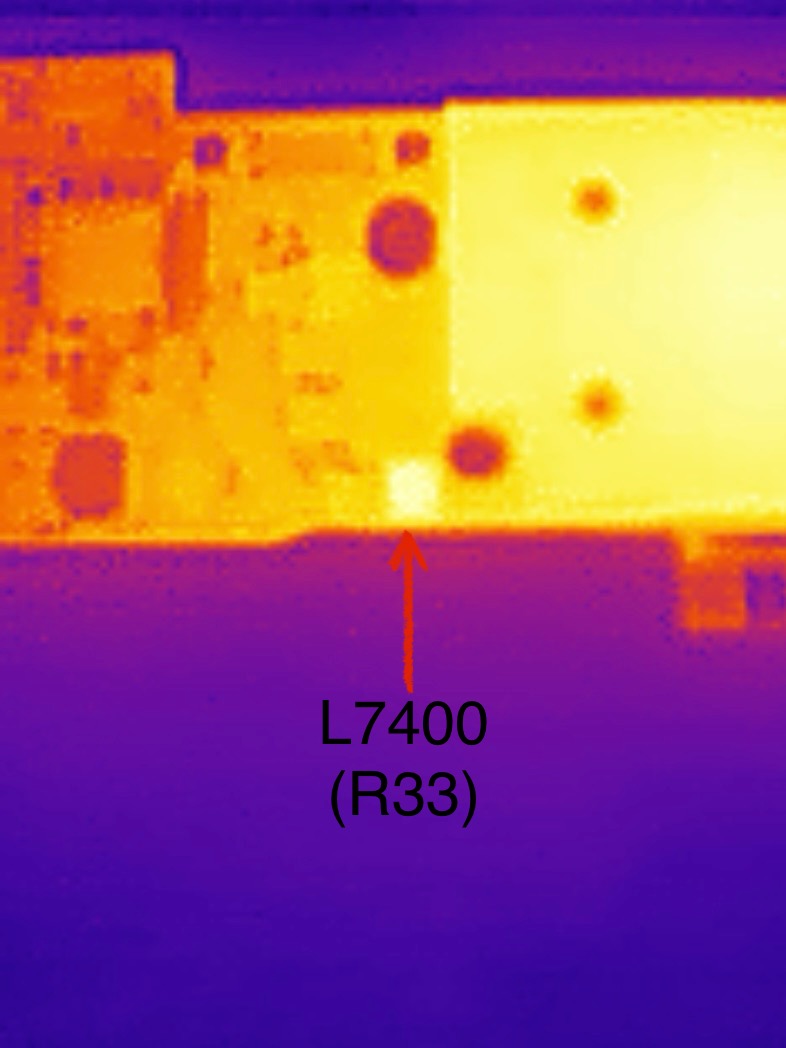

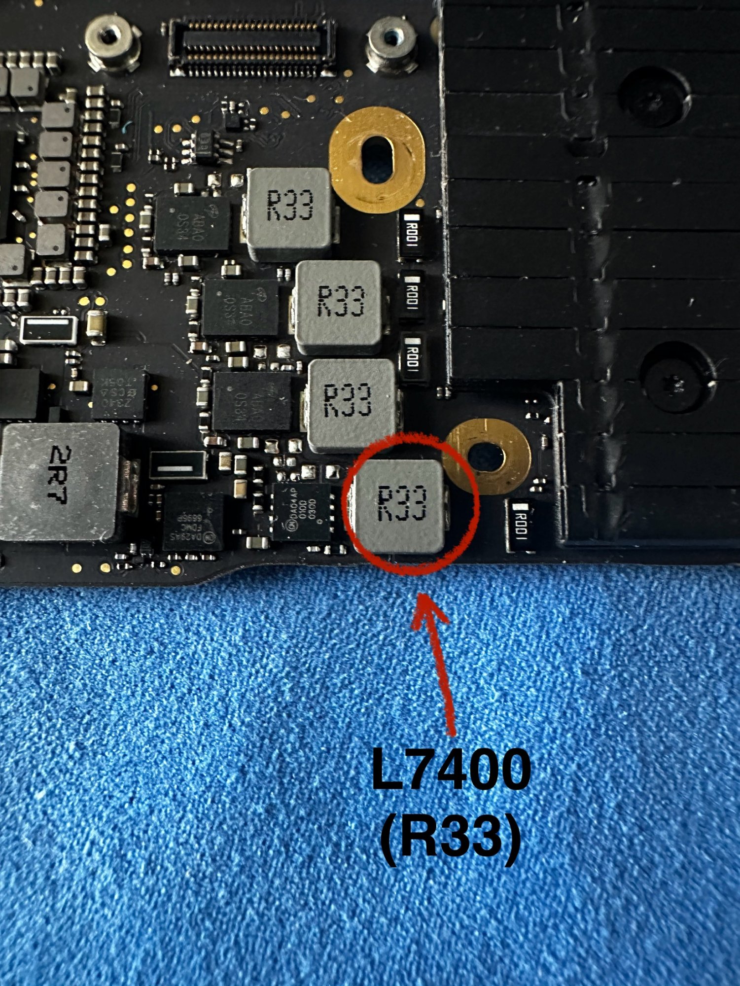

I have a dead MacBook Air (A2179) and I have found the issue using a thermal camera (see photos)
There is a component with R33 written on it, I looked up the schematics and this part is L7400. It’s glowing white hot as you can see in the photos.
Does anyone know where I can buy this part? I live in the UK but happy to buy it anywhere.
Also, does anyone know what this part is called? I could only find the code not the part description.
Any help would be amazing.
Thank you and look forward to any comments.

You can buy it. It’s a 0.33UH inductor. But you’ll need a hot air station to remove and install the component. Might consider taking it to a shop.
Inductor.
JPack, There are 4 of these R33 in a row. Are they all the same value? As when I looked up the schematics they all had different labels. Like L7400, L7230 etc. Bot sure if these are part numbers or just descriptions for its job.

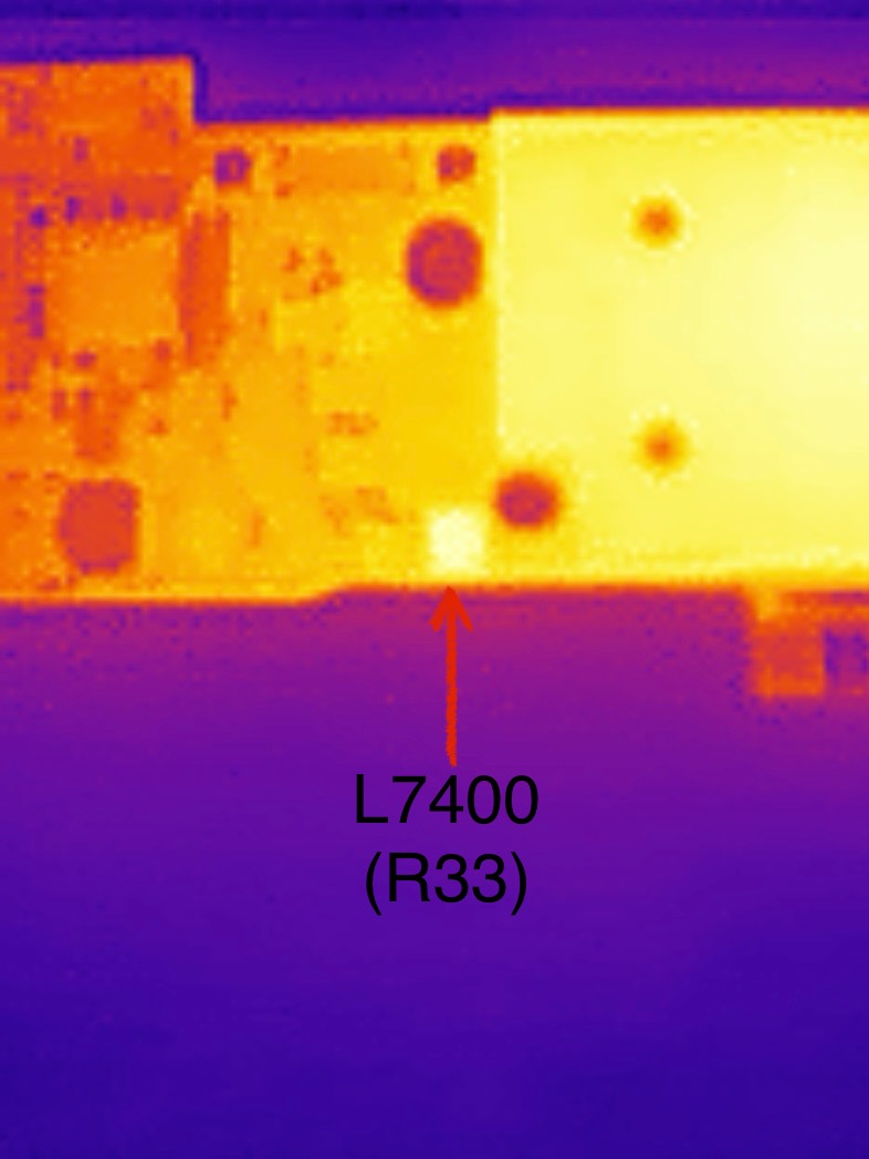

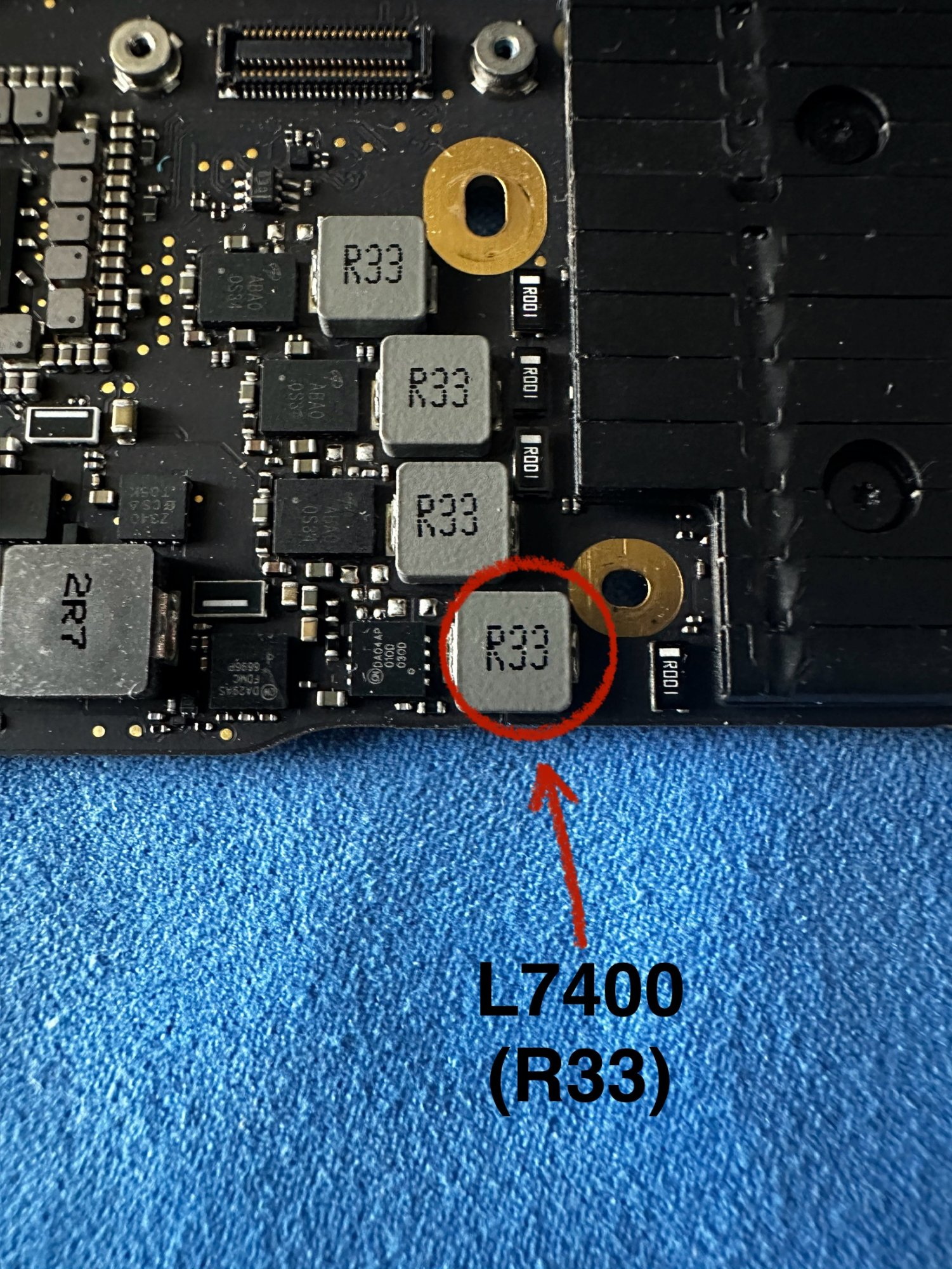

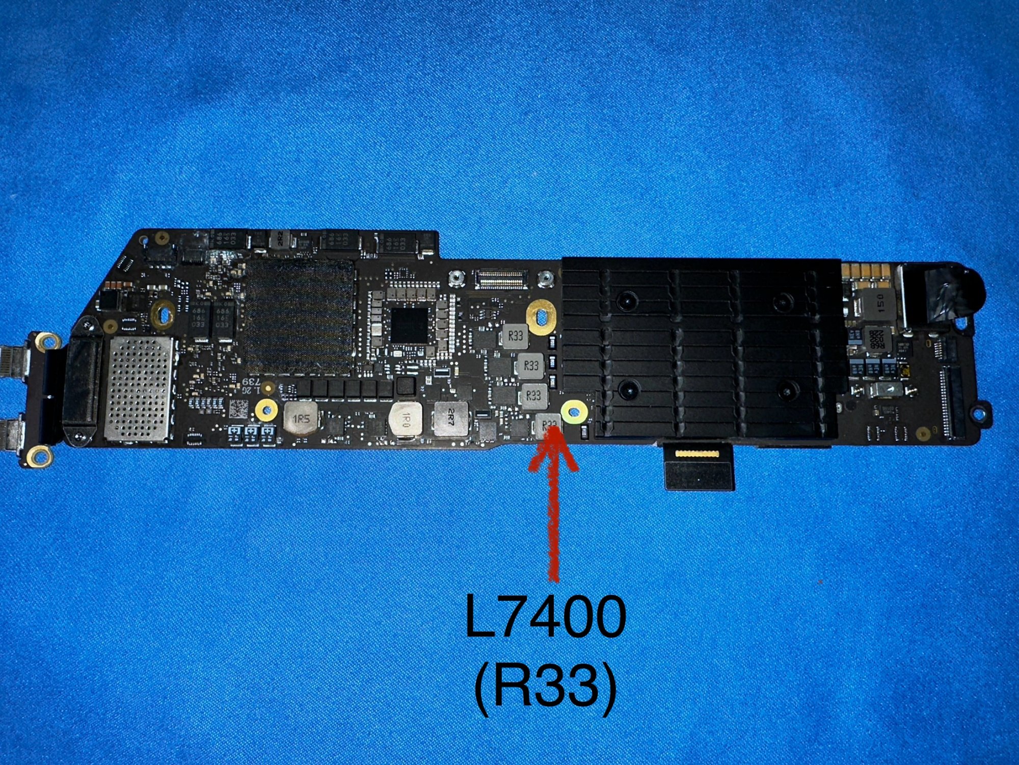

i think most fixers buy it on aliexpress
L7400 should just be the label. The value is R33.

Double check the dimensions to ensure it matches.
