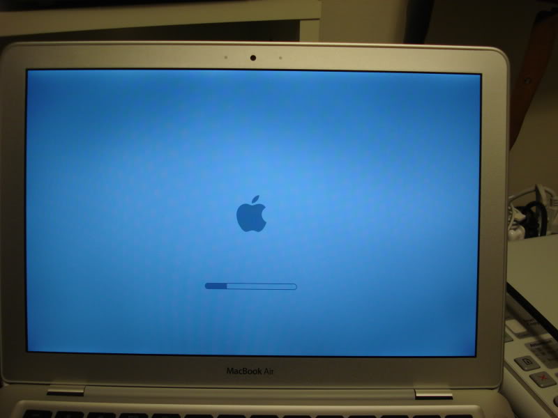

    I am just curious - to me - my MBA screen is acceptable and would never even think of it 'being bad'...
    just curious if others find this screen to be ok since we all have different tolerances for this kind of stuff.... I have dark patches in all the corners. As mentioned - moving around to different angles will change the dark patches - but this is about from straight on and a good representation of it.
    and no - I have no lines on this lcd....
