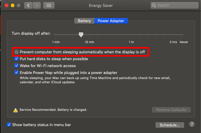

Is it off, or just sleeping?
Check System Preferences -> Energy Saver. There should be a question mark button on the bottom right. Click on it to get more help on various options.
Should I mark this one?

does it turn off in sleep or working? Write clearly
I have to push power key
Boot to the login window
Yes, your battery is acting suspicious. Install a battery utility then report what is says. Probably better to change battery. Did you have any accidents with the notebook recently? New battery is not very expensive, or you might to have change notebook itself (if it is a logic board) but I don't think so. Also, does notebook function normally when on AC power?
When I've check my battery status now, It says "service recommended", so I think my battery is almost dead. What do you mean by notebook?
