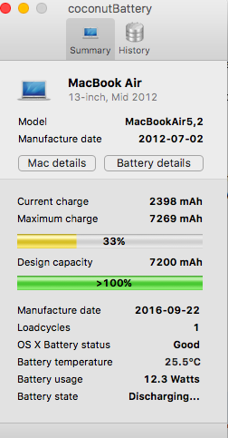

I uploaded images of coconut battery with all details.
I used another adapter, same problem. I also made sure there was no dust on the port.
Macbook air 13 inch mid 2012 mac os sierra

I changed the battery 2 days ago thus its 1 cycle.
You haven't mentioned this in your initial post. It is very important, though as the behavior "might" be related to this. As has been mentioned, I'd let the MacBook get checked by a pro.
