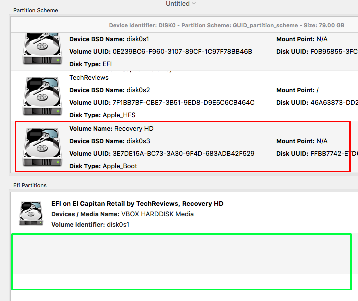

Hello Dan, how u going?
I'm having some isues here... look if you can help me.
- I've already made the bootable pendrive, but as i'm using OS X 10.7.5 on my Mac Air 1,1, I can't download Clover Configurator. So then I started thinking how could I solve this problem.
I finally figured out that installing VirtualBox on my desktop, emulating a version of El Capitan and download Clover Configurator from there would be a good idea, and then I did it.
That was going ok until i start the Clover. Somehow my pendrive does not appear as a mountable device on Clover (the only mountable device that appears is my HD that is emulating VirtualBox)
As you can see here, when I plug my pendrive (it is not plugged now because right now i'm making it bootable again on my mac air, when it become bootable I will plug in and take a screenshot to index here), it appears when the red rectangle is, unavailable to mount. As i imagine, it should appear in the green rectangle, right?

The issue with your original install is most likely that you were using master boot record (MBR) instead of GUID patition table (GPT) so there is no efi partition (as mbr is used for legacy systems which the mac is not and gpt is used for efi/uefi which the mac is)
Hope I cleared things up about that, probably should have mentioned it in the first place! Will be adding that to the original post.
