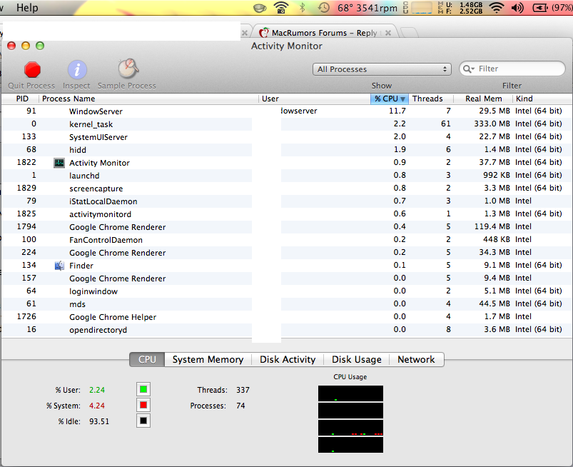

I'm rather annoyed by the heat/fan issues that I've been having as well.
It doesn't happen every time I use my MBA, but I'd say more often than not.
I open it, and it awakes from sleep. Sometimes the heat starts rising immediately, and sometimes it happes later on while I'm using it.
The only applications I have running are Mail, Chrome, and TextEdit. I see no reason as to why the temperature rises to around 70°, and the fans start spinning to cool it down.
If I shut the lid of the MBA to put it to sleep, the screen goes off, but the fans keep spinning (it doesn't really go to sleep). The only way to correct the problem is to restart. Sometimes I have to restart 3-4 times a day. Once I restart, the temperature drops down to normal, and the fans stop spinning.
Does anyone have any ideas on how to correct this?
