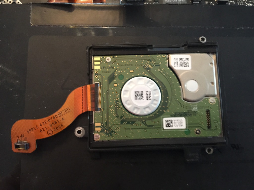

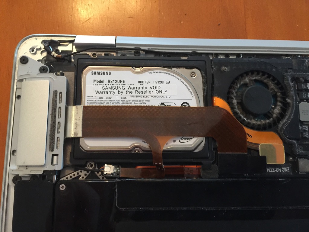

My MacBook Air 2008 (A1304) hard drive had given up, so I purchased the exact same hard drive they come with standard - Samsung HS12UHE/A.
I believe that I had put the new HD in as how I took the existing out, but I am having some problems with the boot. When started, the MBA comes up with a flashing folder with a ? in the middle. I then turned it off, and started again holding down 'option' and all that comes up is the WiFi section (I believe that hard drives are suppose to come up that the MBA recognises).
I am thinking that I have not connected the HD correctly - I have included some photos. If anyone has any clues as to what I am doing incorrectly, or have had similar problems, please help me out!
I have included some photos of how I have connected it up.
Thanks.

Thanks for everyones response. I have created the OS X boot USB, MBA starts up all fine, but when I try to install the OS X from the USB it will only recognise the USB to install the OS X to, so it is not recognising the hd.
I have pushed the ZIF all the way in multiple times, and still no luck..
Any other ideas?
Cheers
Any other ideas?
Cheers
Check if the drive shows in Disk Utility. If it does, erase it and format it as "Mac OS Extended (Journaled)". You should then be able to install OS X.
Still no luck. Drive doesnt come up in disk utilities, I am out of ideas.
