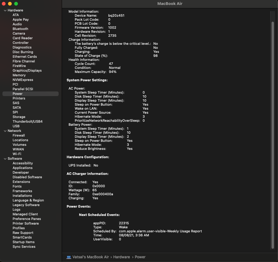

Jan 2021 purchase. 47 cycles, 93% battery capacity. is this normal? Apple support says unless it fails, they will not replace.

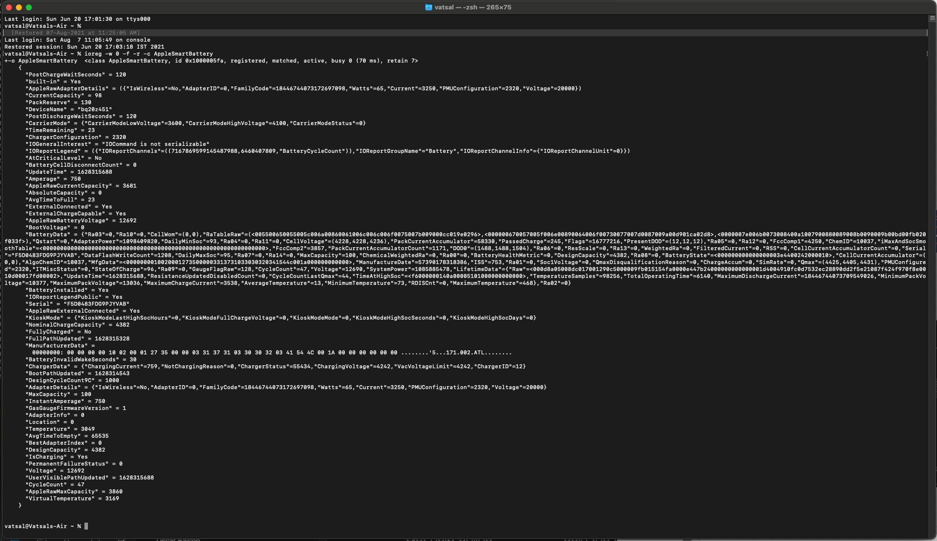

ref. screenshots below.

It only matters if it drops below 80%. Until then, stop worrying. The numbers aren't even real. They're all just estimates and if you stare at them enough you see them go up as well as down.
Just enjoy your computer. If it drops below 80%, your laptop will warn you with a battery warning and ask you to service the battery.

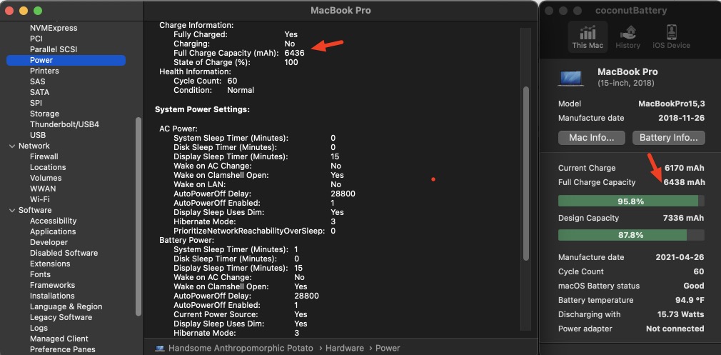

How accurate is Coconut Battery? I just installed it for the first time about a month ago and it has the battery health on my 9 month old, 30 charge cycles M1 MacBook Air at 88.6 while the battery health onboard is at 96. I know it can vary but which would you consider to be more reliable?
Dumb question, but where you do find your Apple official battery health number? My battery app doesn't show that anyplace obvious.
Anyway, Coconut Battery and other similar battery apps are just reading the numbers available in the system report under "About this Mac" and doing the math against the published battery capacity.
The numbers in my screenshot are slightly out of sync, but if I refreshed the numbers, they'd be back in line. The numbers put out by System Report can fluctuate from minute to minute.

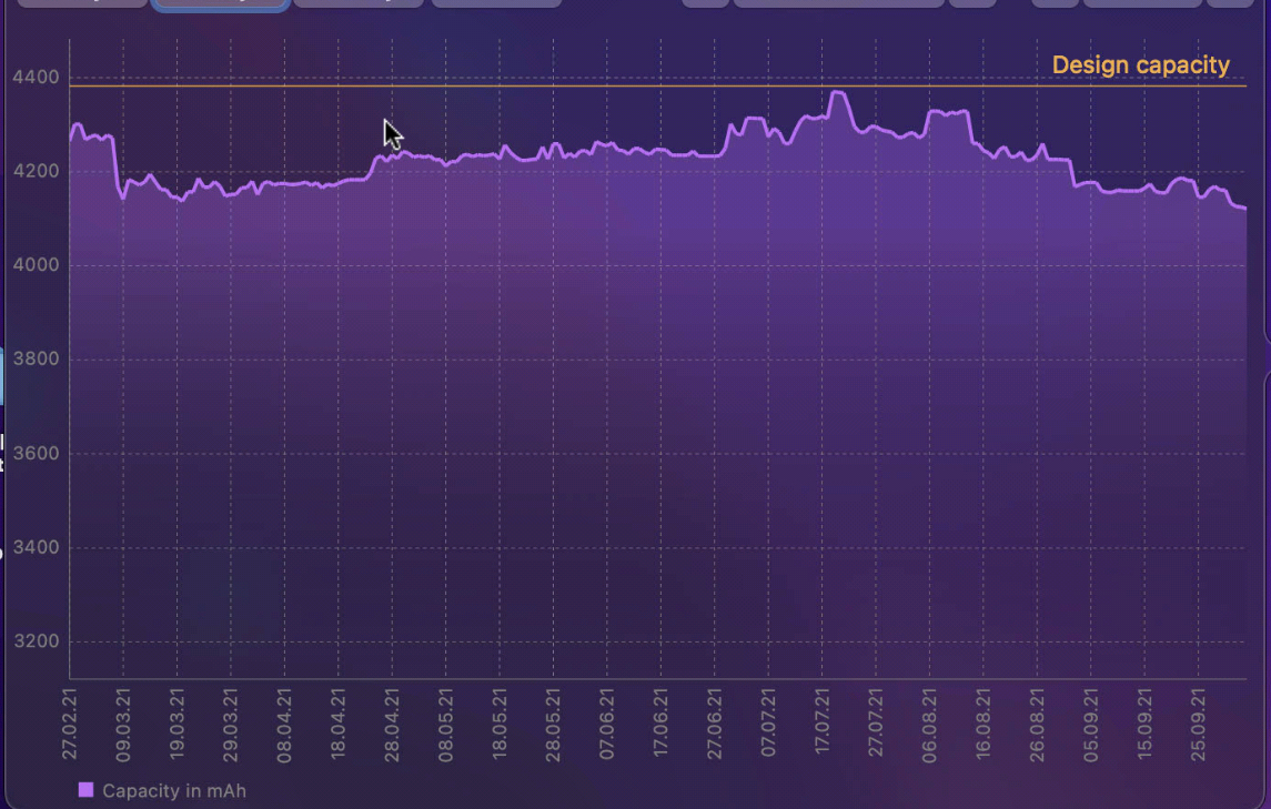

Third party apps like Coconut and Bettery Battery 2 use the ioreg value which fluctuates daily up and down. Because Apple don't want people reacting to these varying numbers they supply a different number calculated in some way which eliminates these fluctuations. When the Apple number drops to 80% they will take notice.

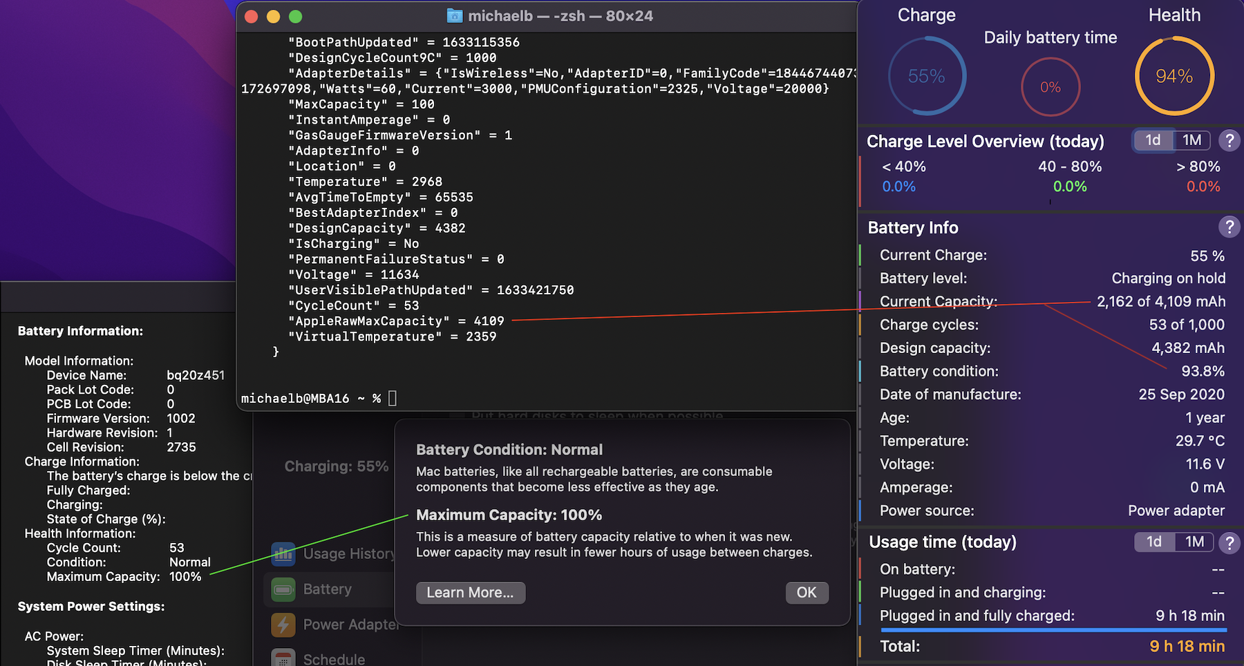

Here is my ioreg number after 53 cycles reported by Better Battery 2 since Feb, when I started using it (Machine was new in Nov 2020). My Apple Sys Info and Sys Prefs numbers are both 100%.
I have used AlDente since Feb to keep max charge to about 60% since I am mostly plugged in.
The Apple number (always the same in System information and Sys Prefs > Battery Health) is not the same as the ioreg number.
Below is a composite screenshot showing the ioreg value appearing in Better Battery 2 with max capacity (=Health) at 93.8%, and my Apple Battery Health and System Info numbers at 100%.
(Edited to show info from same computer as previous post #19)
