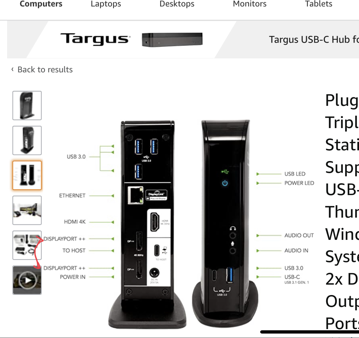

Thank you and yes I know M1 Macbook air natively only supports one external monitor but I was asking about if I needed to get a display link docking station and/or a docking station that has specific ports for displaylink. See pic

I'm still not sure what you are asking. DisplayLink isn't really a type of port, it is a hardware solution for connecting monitors that doesn't require a graphics card. Are you confusing DisplayPort with DisplayLink? You need whatever type of port that your monitor supports. Usually either HDMI and/or DisplayPort.
In short, you need to buy a dock that uses DisplayLink chipset. There are less expensive hubs available with two or more HDMI or DisplayPort connectors. However those rely on DP Alt Mode and do not work with MacBook.

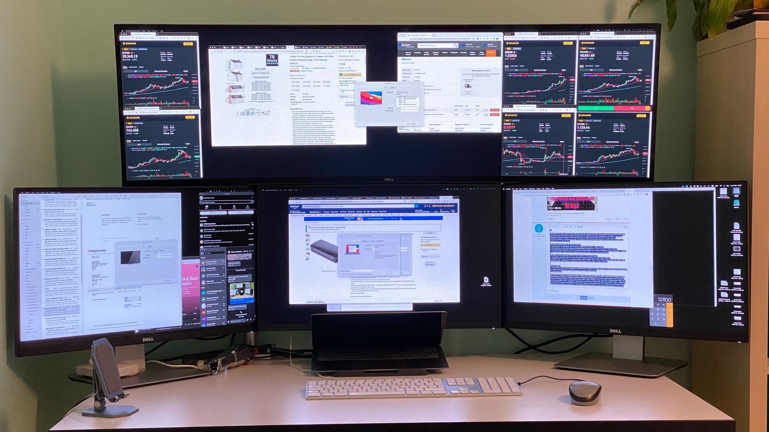

Thanks I got three monitors up and running!
