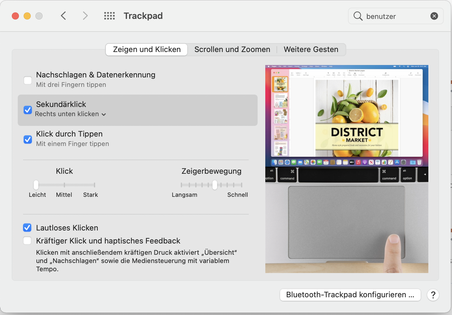

And it does not feel uncomfortable if you click in the middle of the trackpad? My Air feels so strong and the Pro much softer.
Are you aware that you can configure the trackpad under System Preferences - Trackpad, which allows you to adjust haptic feedback among other things.
It is already set to "light" and "no haptic feedback".
