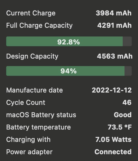

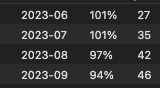

I'm using CoconutBattery to track battery health, and have noticed over last number of weeks, its dropping about a percent a week, being 100% in earlier August but now reported as 94% --- but Apple's setting still says 100%, but less detail provided, to know how accurate that indicator is, much more detail on CoconutBattery app,
for other M2 owners how is your battery health so far? Mine is about 5 months old 100% until earlier august,

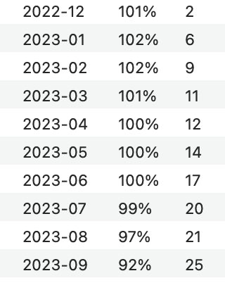

Mine as well, since around 3-4 month I'm losing a lot of battery health :-( it looks very similar. Macbook air M2.

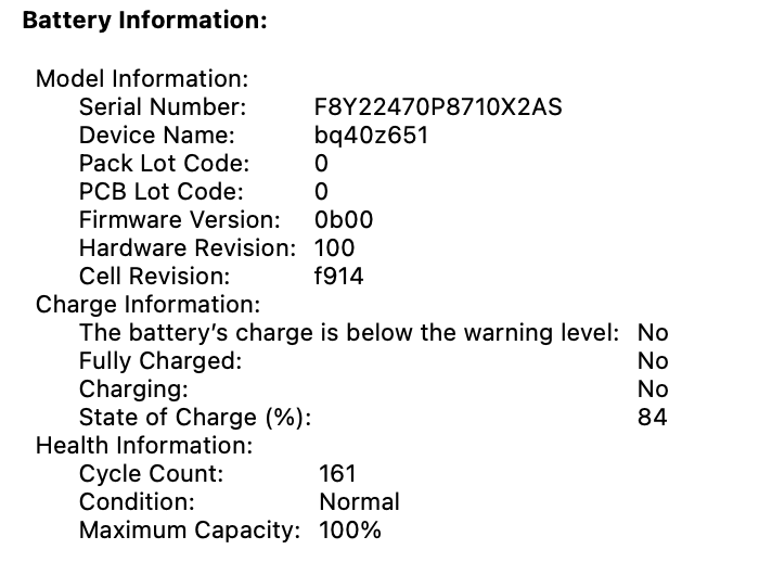

this is the condition of mine purchased july 2022.
they're good for 1000 cycles, give or take.
replacement cost by Apple ASP is A$265 so it's no biggie come the time

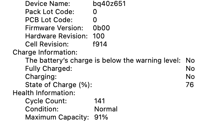

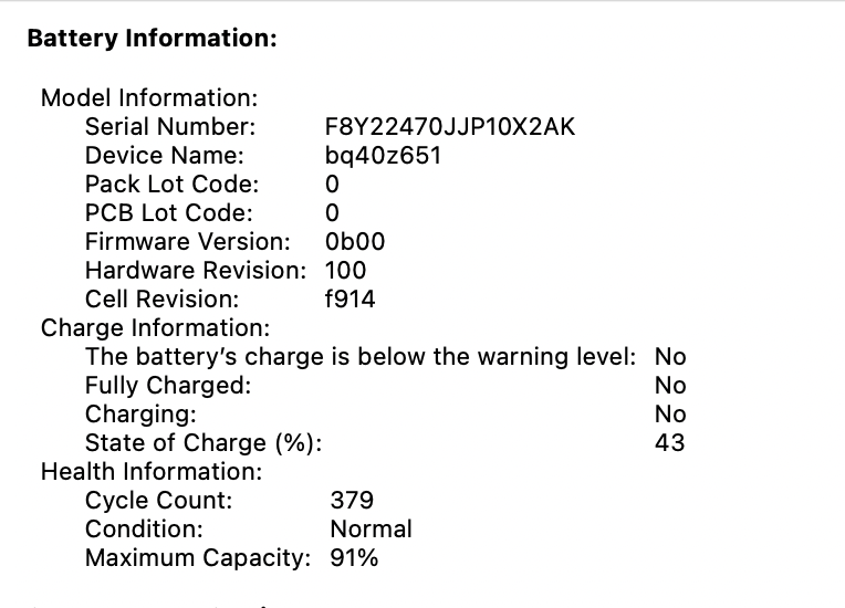

My M2 MBA was at 91% battery health according to the measurement in settings. This was after about a year, I checked it right before I traded it in for the 15in MBA.
I purchased my M2 in July 2022.

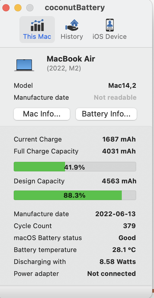

My Coconut reports 93.7% after 161 cycles.
What I also find interesting that the design battery capacity is 4563 mAh, but my laptops started out with 4674 mAh so this leads me to believe as I might have more headroom?
coconutBattery tends to show more degradation than macOS System Information. I use iStat Menus which seems to pull the battery info from the same source.

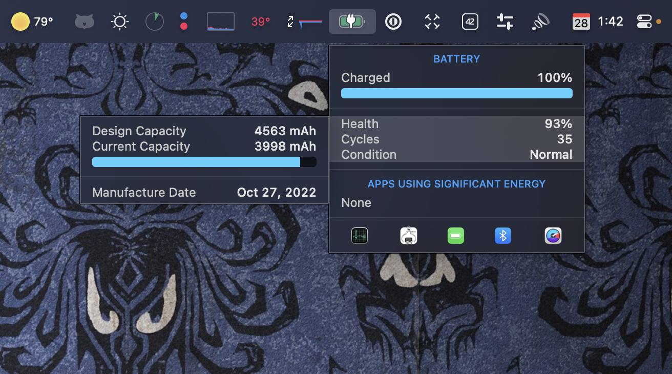

I have two M2 13" MacBook Airs and have noticed a big difference in the battery health between the two. I chalked it up to what I am assuming is two different battery manufacturers.
One MacBook Air has 54 charge cycles and is still at 100% battery health.
The other MacBook Air has only 35 charge cycles and is at 93% health as shown below:
At this rate, it doesn't look like the battery in this Air is going to make it to 1,000 charge cycles within the 80% range, so we shall see. But hey, this is what AppleCare+ is for. And honestly, this Air will probably be swapped out or donated to a family member before then.
I do wonder if this is due to the difference in usage between the two. The one with the 'better' battery health is 4 months old and gets used off power more. The stats pictured above is from my Air that is almost always plugged in and is about one year old.
