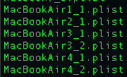

I stumbled today on something interesting. I was researching my issue to see if people with the same laptop, that followed the same firmware upgrade path than I did had similar issues. Long story short, a forum post led me to something interesting, located at /System/Library/Extensions/IOPlatformPluginFamily.kext/Contents/Plugins/ACPI_SM C_PlatformPlugin.kext/Contents/Resources
DISCLAIMER Whatever you do, do not try to remove / move anything in this folder.
What is interesting is that my Macbook Air has the following identifier : MacBookAir5,2. However, in the above-mentioned folder, there is no MacBookAir5_2.plist, it stops at 4_2.plist and then goes on to MBP models. Now, the question that I have is could the fact that this plist is missing be related to my battery issues ? In the sense that without this file, the kernel does not know how to properly manage the power, read the battery status / thermal sensors ?

Would it be possible for people with Macbook Air from mid-2012 or newer (so MacBookAir5.2, 6.1 or 6.2) to check if in the path I typed in my original post, they have a plist for the MBA 5.2 ? Or newer ones for that matter ? It would make my day 🙂
I just checked on a default Mavericks install on my 2014 rMBP and see the same plist sequence you do (with no MBA5.2), so I'm guessing that is not your issue and the OS is using one of the other compatible battery profiles.

Thanks Weaselboy ! It doesn't seem to be related to my issue then.
I also owns a Macbook Air from mid 2012. Would this be a problem from Apple? I get around 3-4 hours in a full charge with basic web surfing.
I tried going to the path:
I have the same stuff as you do. I also have 78% health for my battery after 348 cycles. I get more than 5 hours. I get roughly about 4-5 hours when doing web development and roughly 6+ hours if I'm just using a text editor and web browsing.
