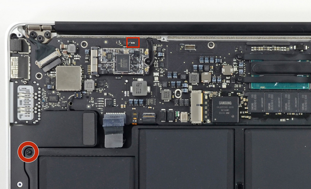

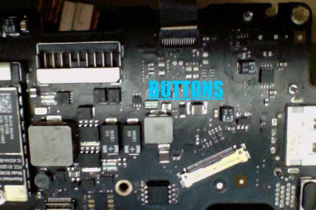

My MBAir will not power on unless i tap a small screwdriver on 2 silver dots below the keyboard ribbon on the logic board for a couple of seconds, see if that should fire up the macbook air.
Are you sure the buttons are near the keyboard ribbon in a 2013 Air? I thought the keyboard ribbon connects to the trackpad and the buttons are near the wi-fi card.
its worth a try?
In a mid-2013 to 2017 Air, the buttons are next to the WiFi card.
Your picture
thanks. I will delete that pict then, the purpose of the comment was to try that procedure.
I really hope that works!
Your picture may be perfectly valid.
The OP thought it might be a 2013 Air which is why I posted another picture from ifixit.
